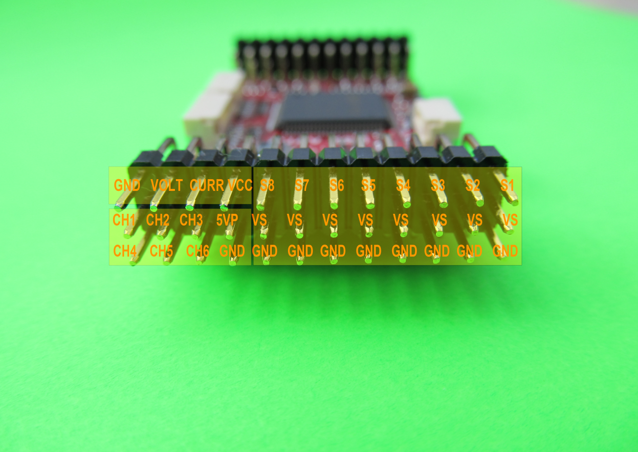

8 x Servo outputs
6 x Aux outputs

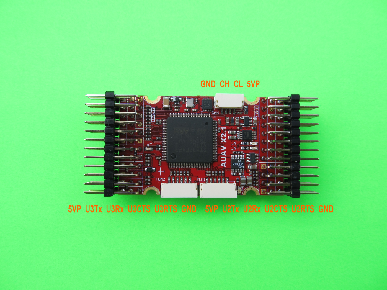

CAN
USART2 with flow control (Telem 1)
USART3 with flow control (Telem 2)

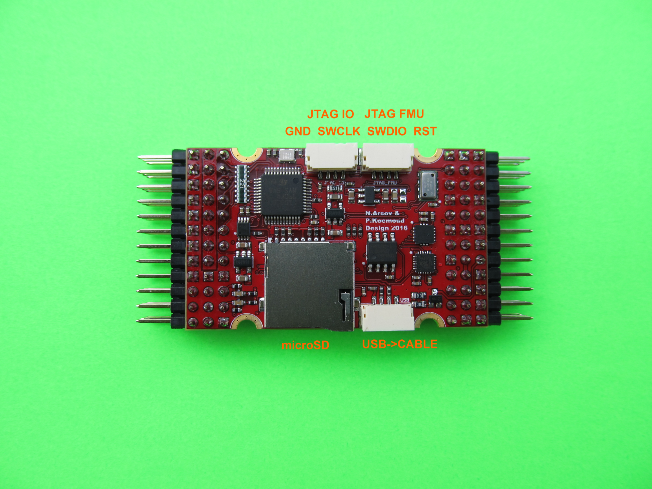

USB (150mm GH to Micro USB cable included for convenient mounting)
JTAG FMU Processor
JTAG IO Processor

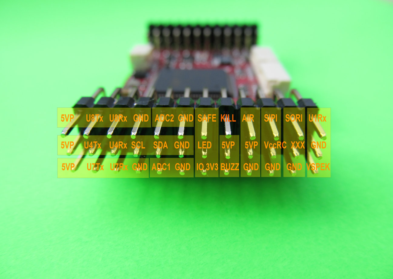

What’s the “KILL” pin on the front headers?
This is SBus Out, No Connection, Ground. We do not intend to provide power from this connection.
So the ‘Kill’ means the SBUS output is not used? Will it be opened in future?
Nice! Please make sure to sync with me on the boot loader. I want to make sure users can use the 2MB flash and that will require proper identification in the bootloader and a new Firmware config.
@Orico4 Sbus out should work the same as on Pixhawk (FMUv2). I haven’t tested it myself though.
And Sbus out is the pin labeled “SORI”, not KILL
KILL is not connected currently and will be used in the future.
SORI = SBus Out / RSSI IN
SIPI = SBus IN / PPM IN
Both signals have 100% the same function as of Pixhawk.

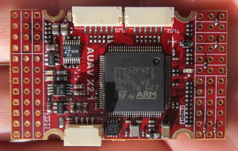

The main differences between X2 and X2.1 are:
  1. Sensors - X2.1 uses MPU9250, ICM20608 ( baro is the same - MS5611 )
  2. Power manager - X2.1 uses LTC4415 for Brick/USB OR-ing, plus MOSFET for reverse polarity protection
  3. TPS2066 current limited switch for 5V_PERIPH
  4. TJA1051T for CAN
  5. Ultra low noise LDOs for 3.3V
  6. 220R to all I/Os
  7. FMU battery backup
  8. IOSoC uses STM32F103C8T6 instead STM32F100C8T6
The new board looks good Phil! I like the usb connector, creates easy access to connect to, the one thing I always have trouble with in the first version. Great job!
