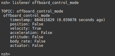

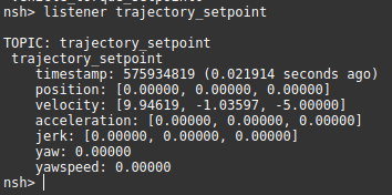

could you check from the nuttx console that you are indeed receiving the offboard_mode messages? Let’s try to narrow down what is causing the issue.
@Benja Thanks for the reply,
I have checked from nuttx console with $listener trajectory_setpoint$ and it shows it’s actually receiving normally. (here it’s a velocity setpoint, but I have tried pos, vel and accel to no avail)
