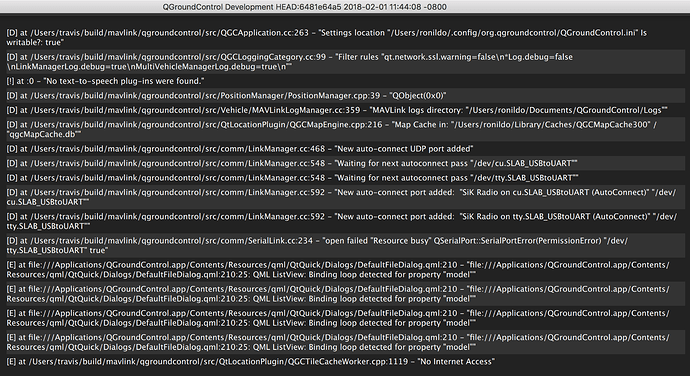

Hi guys,
I am just wondering if it is possible to connect QGroundControl to a Pixracer 1.4 through wifi.
Everything works fine though usb cable but QGroundControl is not able to connect through wifi.

Turn on LinkManagerLog and MultiVehicleManagerLog as shown here: https://docs.qgroundcontrol.com/en/SettingsView/console_logging.html. Save the log, zip it up and link to it here and I’ll take a look.

Just do those two logs only. Otherwise too much noise. Then reboot QGC, turn your vehicle on and save the log.
Hi, Thanks again for your help, please have a look below
[D] at /Users/travis/build/mavlink/qgroundcontrol/src/QGCApplication.cc:259 - “Settings location “/Users/ronildo/.config/org.qgroundcontrol/QGroundControl.ini” Is writable?: true”
[D] at /Users/travis/build/mavlink/qgroundcontrol/src/QGCLoggingCategory.cc:99 - “Filter rules “qt.network.ssl.warning=false\n*Log.debug=false\nLinkManagerLog.debug=true\nMultiVehicleManagerLog.debug=true\n””

[D] at /Users/travis/build/mavlink/qgroundcontrol/src/comm/MAVLinkProtocol.cc:413 - “Orphaned log file count 0”
[E] at /Users/travis/build/mavlink/qgroundcontrol/src/QtLocationPlugin/QGCTileCacheWorker.cpp:1081 - “No Internet Access”
[D] at /Users/travis/build/mavlink/qgroundcontrol/src/comm/LinkManager.cc:461 - “New auto-connect UDP port added”
Ok. The UDP port is being opened correctly. QGC is just not seeing a HEARTBEAT come through the connection. So likely something wrong with the hardware setup somewhere.
Other thing is to make sure you are trying a daily build. Not sure what version you are using.
Do you know how can I setup the hardware to fix this hardware setup problem?
I also downloaded the latest version of the QGroundControl, please see image below.
