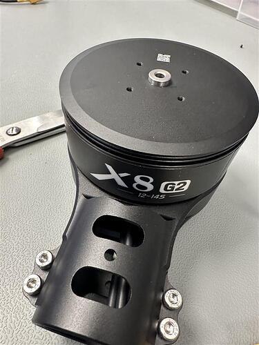

Recieved some newly released Hobbywing X8 G2 motors / ESCs and I’m trying to make it work over CAN using PX4 with a Cube Orange Plus, but was not successful.
I am able to set up the motors using Ardupilot and their Hobbywing guide:
For some reason, they come configured with 500k baudrate but after following the ardpilot docs I’ve set it to 1M baudrate but I’m still not able to get CAN to work on PX4 with them.
According to their website they say they work with PX4 but there is no documentation about CAN usage.
Any help/tips using CAN on PX4 for hobbywing ESCs or how to diagonose/test CAN on PX4 is greatly appriciated.

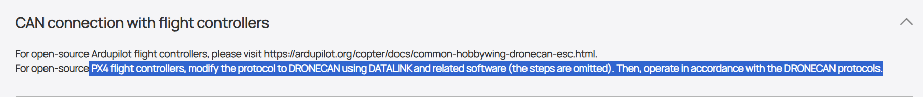

According to the X8 G2 FAQ it can be configured to DRONECAN and work with PX4 if you get their DATALINK adapter and program it

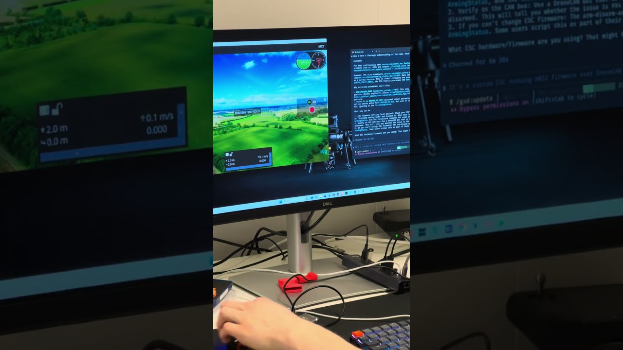

Okey, I got it working, but it wasn’t straightforward.
  1. DATALINK software has to be FW 2.16 or higher or it wouldn’t connect to my X8 G2. Mine arrived with 2.09 when I received it Feb 2026.
    • The Datalink dongle can be upgraded with the DATALINK software (see video)
  2. DATALINK can set the CAN protocol form HWCAN (hobbywing can) → DRONECAN (UAVCAN that px4 uses).
    • The software is all in chinese so which buttons to “scan”/“connect”/“save” are not obivious, see video for more help.
