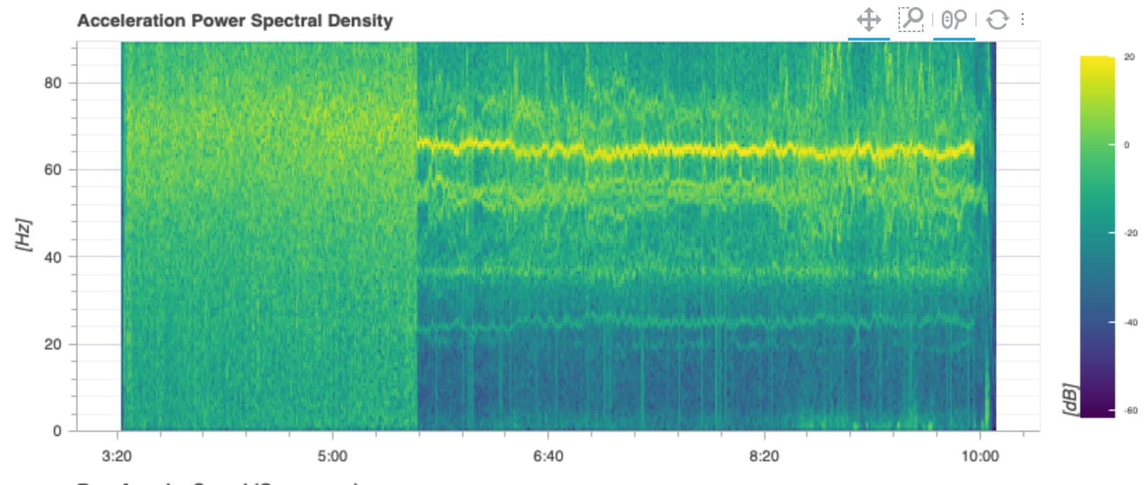

that my sampling regularity jumps around a lot. Here is an example from a flight a while back along with the accel PSD showing the improvement in the frequency resolution after the regularity stops jumping around. This is odd, but likely unrelated to the high accel magnitudes, which you can see in the bottom plot are quite high for this entire flight.

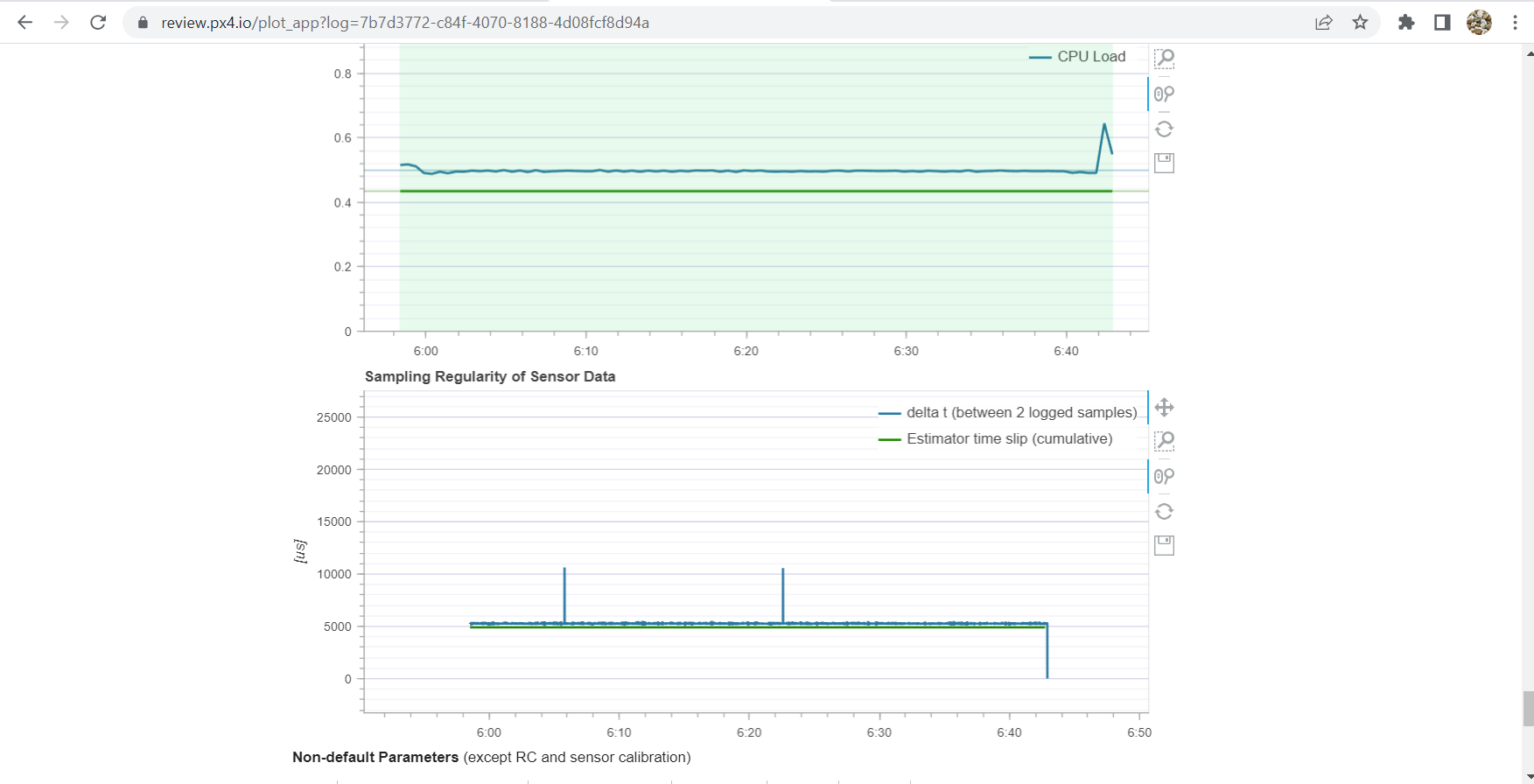

@mwshafer …well you wont believe what i got today about sample regularity after doing a flight test at low height with an " approx. PID " tuned F.C

I had a 13 minutes flight time after the previous test demo ( PX4 v1.13.3 ) and surprisingly the drone flew well even in position mode without any much glitch …logs below
https://review.px4.io/plot_app?log=d7f76003-ff10-4d48-b5e1-53a6382f3485
My observations are as follows
a) Never switch ON the drone and move around to your launching pad rather switch ON the
drone after you place the drone on the launching pad !!
b) There is a improvement on the RAW acceleration .
c) Vibration metrics seems the same high end !
d) The test was done at full battery capacity till it reached 7% warning .
e) Sampling regularity of sensor data looks good. I have no idea how it became better !!

Do you see those peaks in the angular velocity FFT?
Those vibrations are probably generated by your drone and amplified by the rate control loop. You should:
