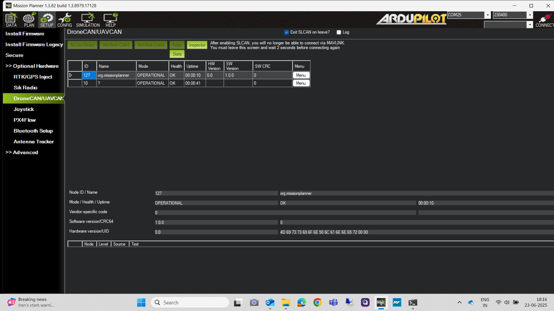

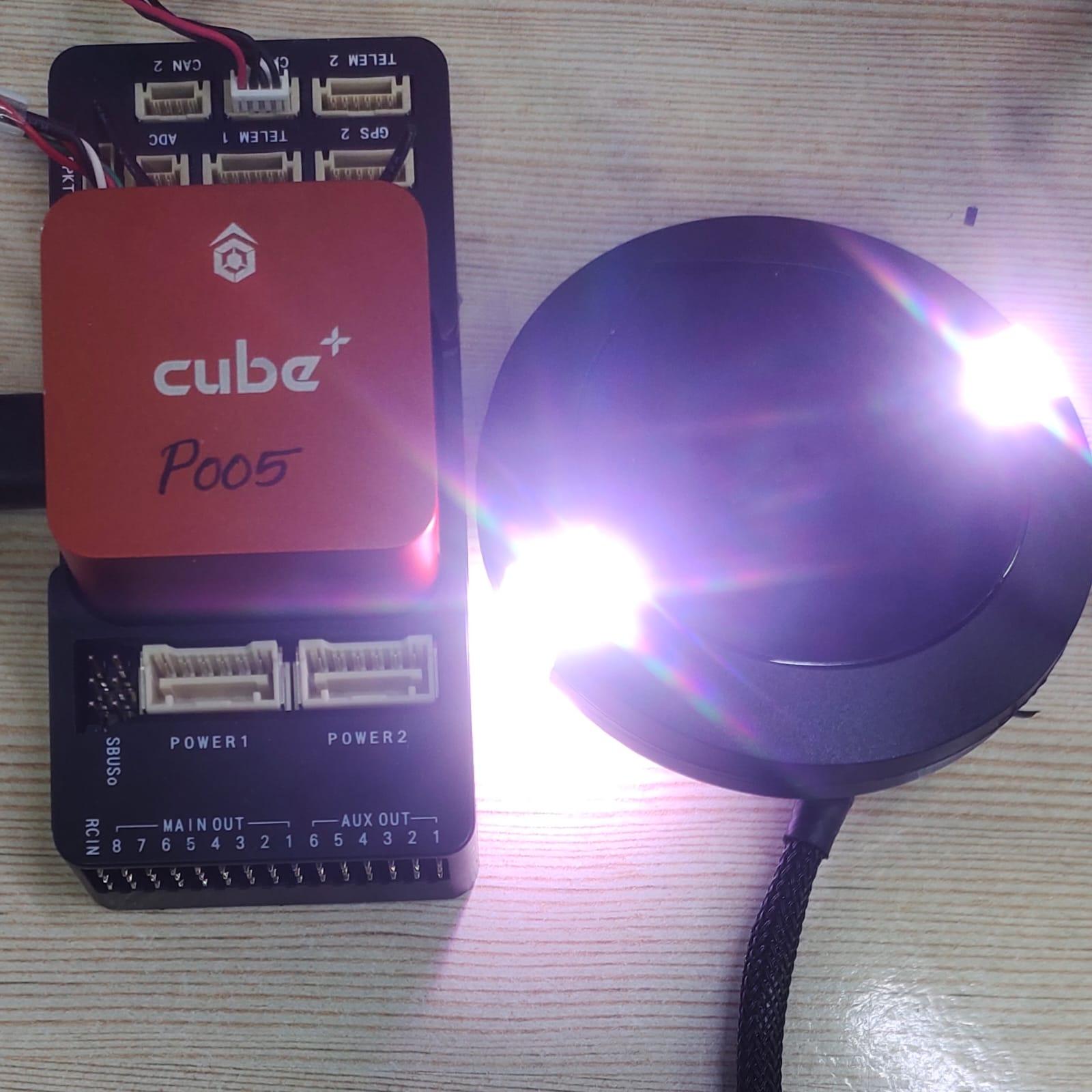

Hello Experts,
I am facing a issue where my Here 4 GPS is stuck at white light randomly after some flights (happened on 7 new GPS out of 100),
Configuration:-
I am using PX4 (1.15.2) autopilot running on Cube orange+, with Here4 GPS
Once the solid white light appear, the GPS is not detecting by the PX4. I also uploaded Ardupilot but the problem remains the same.
I also tried to update the firmware on the Here4 GPS using ardupilot and mission planner [https://docs.cubepilot.org/user-guides/here-4/here-4-manual#id-3.-firmware-update](https://official website)
but a ? symbol appears in the name column, No HW version, No SW version,
I am not able to communicate with the GPS through Drone CAN GUI tool, nor by Ublox Ucentre tool,
I am attaching a log file and videos for reference June_12_HERE4_Issue
Please help me to solve the issue.
