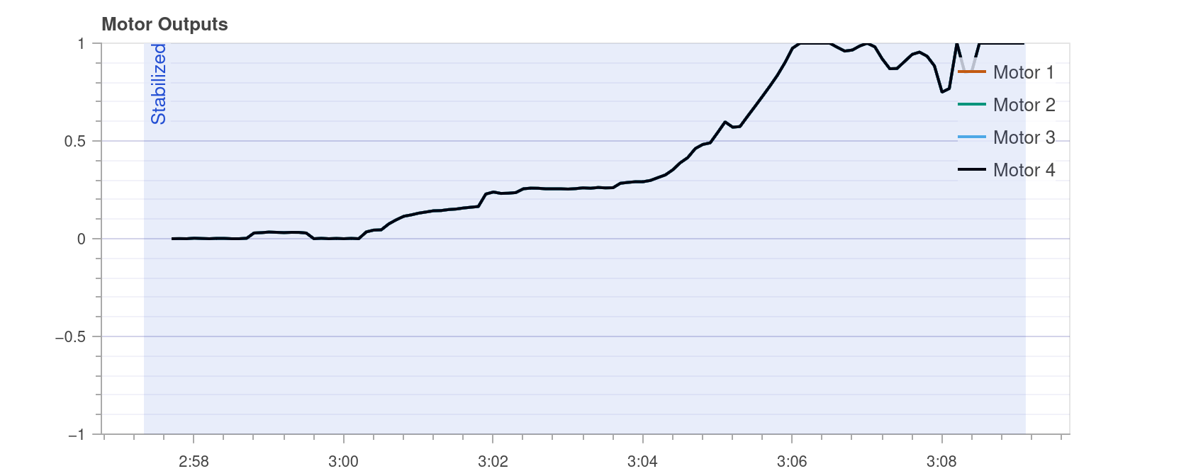

Hi All
New over here with PX4,
Piloted my 1st drone and it crashed on its maiden.
Specs:
Frame: Tarot X690
Autopilot: V6XRT
Firmware: V1.17.0 Alpha
ESC: Xrotor 40A Pro
Motor: MN5008
Prop: 16inch
AUW: 2.7kg
Commands.
Drone was Armed through GCS; took off in stabilize mode.
Throttled up to 40%; drone suddenly shot to the sky.
Throttled downed to 0%; drone continued with climb.
Kill switch engaged; drone crashed
I am at loss over here; not sure where I went wrong.
Can someone help me out investigating this and how to prevent it in the future.
Thanks
https://review.px4.io/plot_app?log=2cdce15e-191c-4541-bf04-d8d5496a9cd3

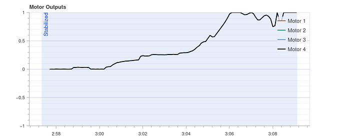

What’s your motor configuration in QGC? Why do they all have the same output? That’s suspicious.
I’m using a Quad X configuration.
Yeah the motor output looks suspicious.
I had no control over the drone, it just went 100% throttle on the motor even when i was 0% on CH3.
Check the actuators tab in QGC. Maybe take a screenshot of it and share it here.
