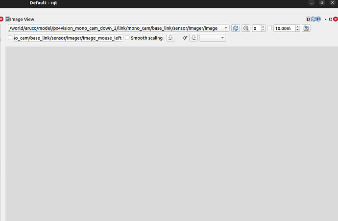

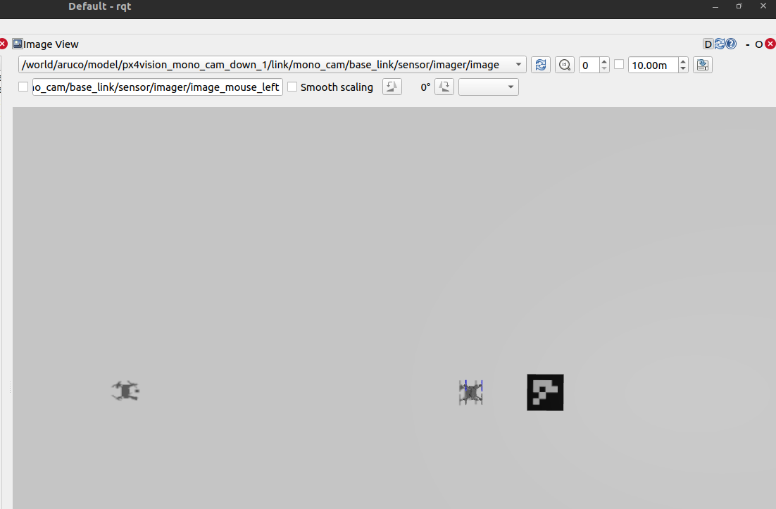

Hi, Sorry to bump this old conversation but I would like to share the solution that worked for me, in my case I added the Gazebo plugin like this:
        <plugin name="camera_controller" filename="libgazebo_ros_camera.so">
          <alwaysOn>true</alwaysOn>
          <updateRate>0.0</updateRate>
          <cameraName>my_namespace/camera</cameraName>
          <imageTopicName>image_raw</imageTopicName>
          <cameraInfoTopicName>camera_info</cameraInfoTopicName>
          <frameName>mono_cam/base_link</frameName>
          <namespace>my_namespace</namespace>
        </plugin>
Like this I am able to see both images.
Camera of drone 1:

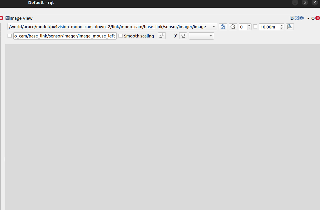

Camera of drone 2 (Drone 2 is on the ground):
The only problem I encountered is that the topic is quite lengthy, but I think this would be a non-issue due to launch files. I just thought of this solution, I will update if I think of a more refined approach.
hi sorry but may i know where did you put that plugin, and also when I run that have an error in the px4 saying pxh> [Err] [SystemLoader.cc:92] Failed to load system plugin [libgazebo_ros_camera.so] : Could not find shared library.
It will work only for gazebo classic right not for the ignition.
