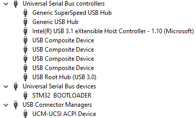

I have successfully bootloaded the board, however when I plug in the USB on the board, QGC does not recognize the board to flash the fw. Can someone help me
If I switch boot to 1, there is a stm32 bootloader device
