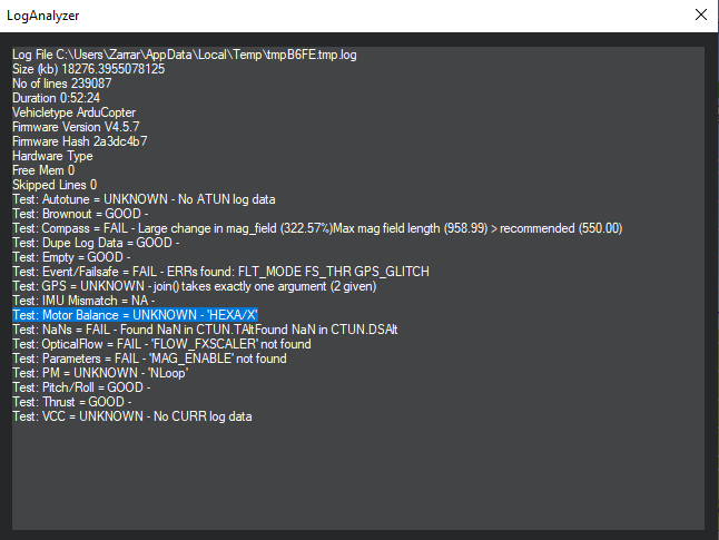

  • The GPS gave me a hard time during Compass Calibration, the progress bar kept resetting after coming to 99% and starting over and over again so I set its fitness to “Relaxed”, I am using both, the GPS and Pixhawk’s internal compass.
  • The “Compasses Inconsistent” error pops up often on Mission Planner, even if I slightly nudge the GPS.

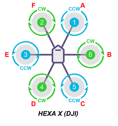

  • I definitely have the motor configuration incorrect. I didn’t test it before because I either didn’t read through the manual completely or it doesn’t contain this info, but I finally found the Motor Test option in Mission Planner and the motors are indeed all over the place. I set them up in a Hexa X (DJI) config because I thought that the kit is DJI.
I have attached the DataFlash log in both, .bin and .log format as well as the result from the Auto Analysis.
