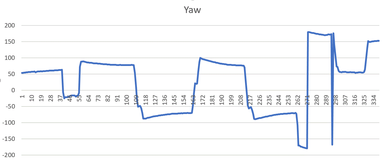

When will this be available? I am getting some weird yaw readings and want to see what is causing this.

Does the external magnetometer need to be mounted on the same plane of the copter? There is about a 7degree difference in pitch from the board and external mag. Would that cause yaw issues similiar to what I’m seeing?
