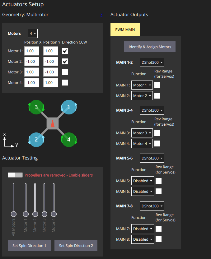

I just flashed a new Kakute H7 with latest firmware and 2 motors are mapped on the same one and one of the 4 motors won’t spin. Essentially in QGC when I raise ALL slider just 3 motors spin, and when I raise each slider 2 spins the same motor.
I tested the Tekko32 ESC and works great with Betaflight so the wiring is correct but I can’ make it to work with PX4.
I would like to know where in PX4 the 4 motors are mapped for the Kakute H7?

I configured the motors for a quadcopter airframe, set the DShot300 protocol, assigned to each of the 4 PWM MAIN the 4 motor functions, and rebooted.
Then I tested the motors by pulling up the ALL slider in the ACTUATORS page of QGC, and only 3 motors spun: one spins much faster than the other two, and another spins twice, so it is activated using 2 different sliders during the assignment phase. Essentially, when I use each slider, 2 sliders activate the same motor, so there are a total of 3 motors spinning during the “Identify & Assign” process.
I think something is going on with mapping of the motos in PX4 for Kakute H7 FCU. Where can I verify that?

This is my Actuators tab:

The board I’m using is a Kakute H7 v1.2 + Tekko32 4in1 ESCs am32. I also tried with the BLHeli32 ESCs version but I get the same motors overlapping.

Ok thanks. I’m trying to reproduce this on my KakuteH7 v1.3 with some 4in1 BLHeli32 ESC and I can’t see the problem. I tried both PX4 from todays main branch as well as stable/v1.15.4 flashed via QGC.
I have M1 to M4 connected, plus GND. Given the timer_config you mentioned above, I’d be very confused how you see this happen.
When you do a param show -c to check all changed params, does anything odd show up? I’m trying to make sure that it’s not some leftover flash data messing with parameters, which was only fixed with [Sponsored by CubePilot] Params in flash erase fixes by julianoes · Pull Request #24371 · PX4/PX4-Autopilot · GitHub.
And I’m testing this without bidirectional DShot because that only works for the first timer at the moment, so M1 and M2.

  • Again, just three motors spin and sliders Motor2 and Motor3 activate the same brushless. Even when in the process of assigning the motors, it spins twice the same motor.
Is there something you are doing differently? How can I check/test the motor-function mapping from the MAVLink Console in QGC?
