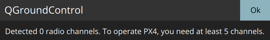

I’m new to QGroundControl and I’m trying to set up my PixHawk 2.4.8 for the first time. I have connected my FlySky receiver to the PPM/SBUS port on my PixHawk. I have adjusted the RX settings on my remote transmitter so that its output is in PPM and SBUS. I’m not sure why I’m getting this error:
I tried getting data from the MavLink console:

What should I do? How do I resolve this error?
