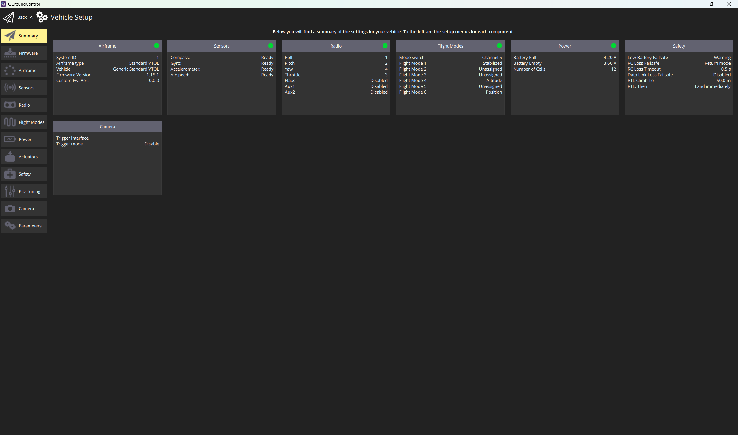

Hardware/Software:
Drone: YangDa Sky Fury (link)
Configuration: Standard VTOL
Controller: CubePilot Cube Orange+ (link)
Firmware Version: 1.15.1
Companion Computer: AmovLab Allspark2-Orin NX (a customized version of Jetson Orin NX) (link)
CPU Architecture: ARM
Computer OS: Ubuntu 20.04
ROS Version: ROS2 Foxy

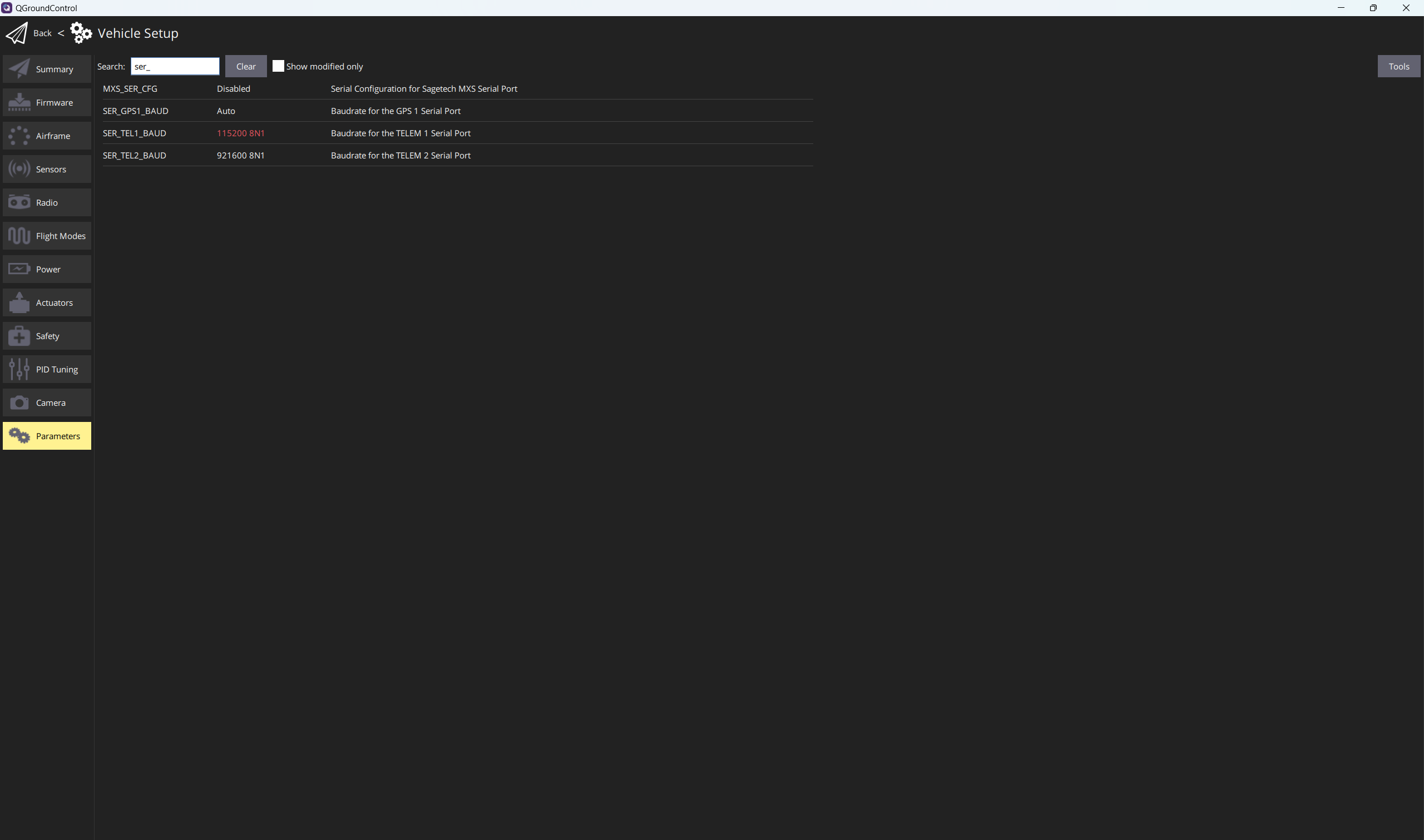

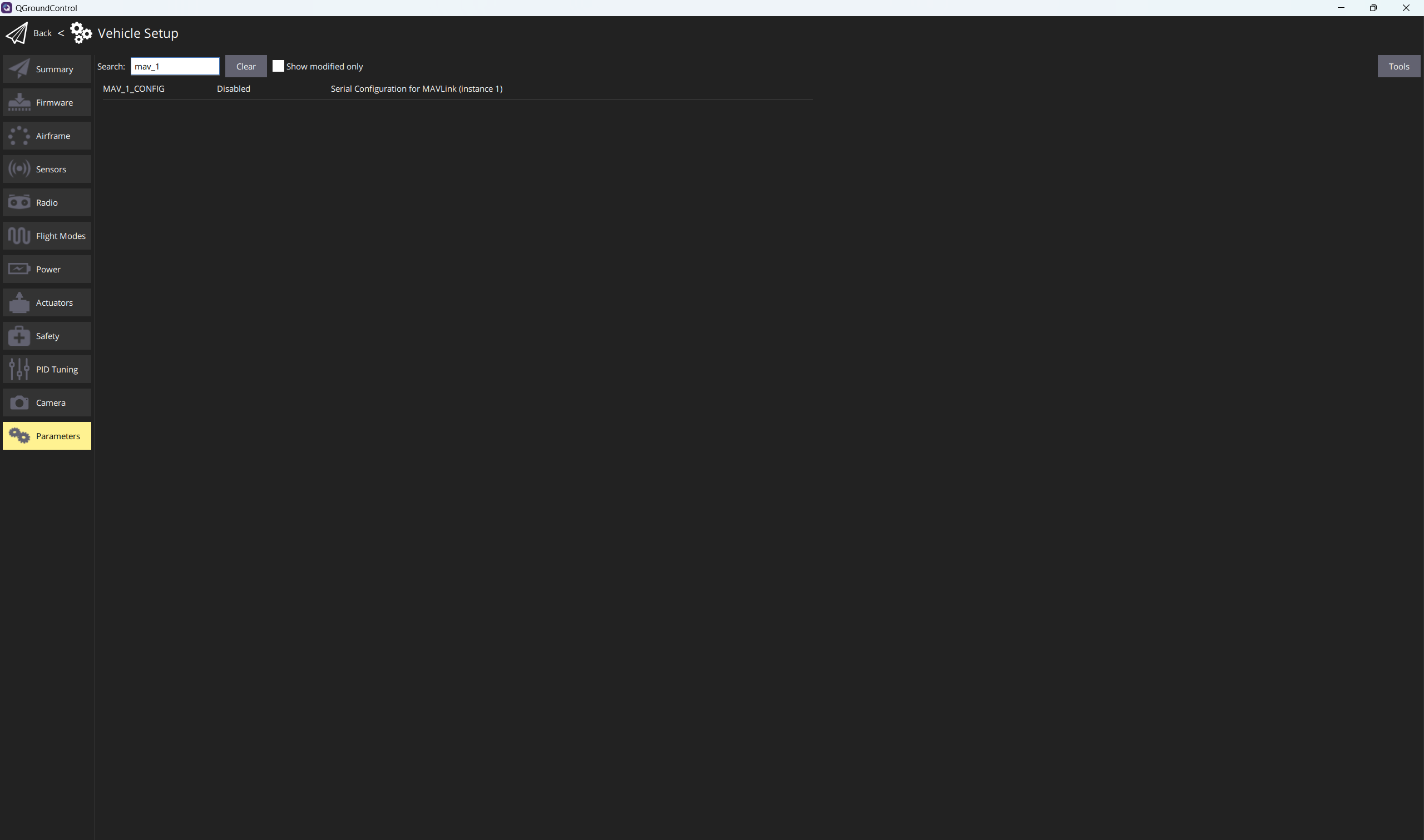

  • Set MAV_1_CONFIG to 0.

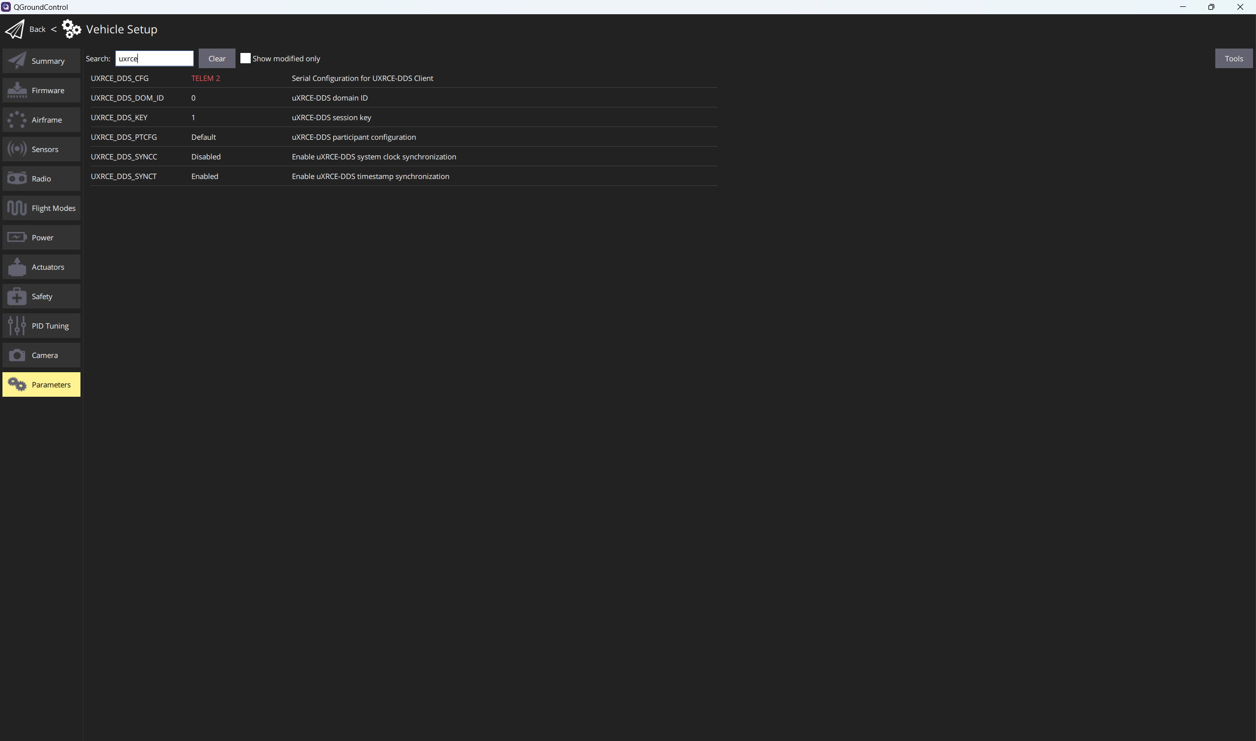

  • Set UXRCE_DDS_CFG to 102(TELEM2).
  • Set SER_TEL2_BAUD to 921600.
  • In MAVLink Console run uxrce_dds_client stop then uxrce_dds_client start -t serial -d /dev/ttyS1 -b 921600.

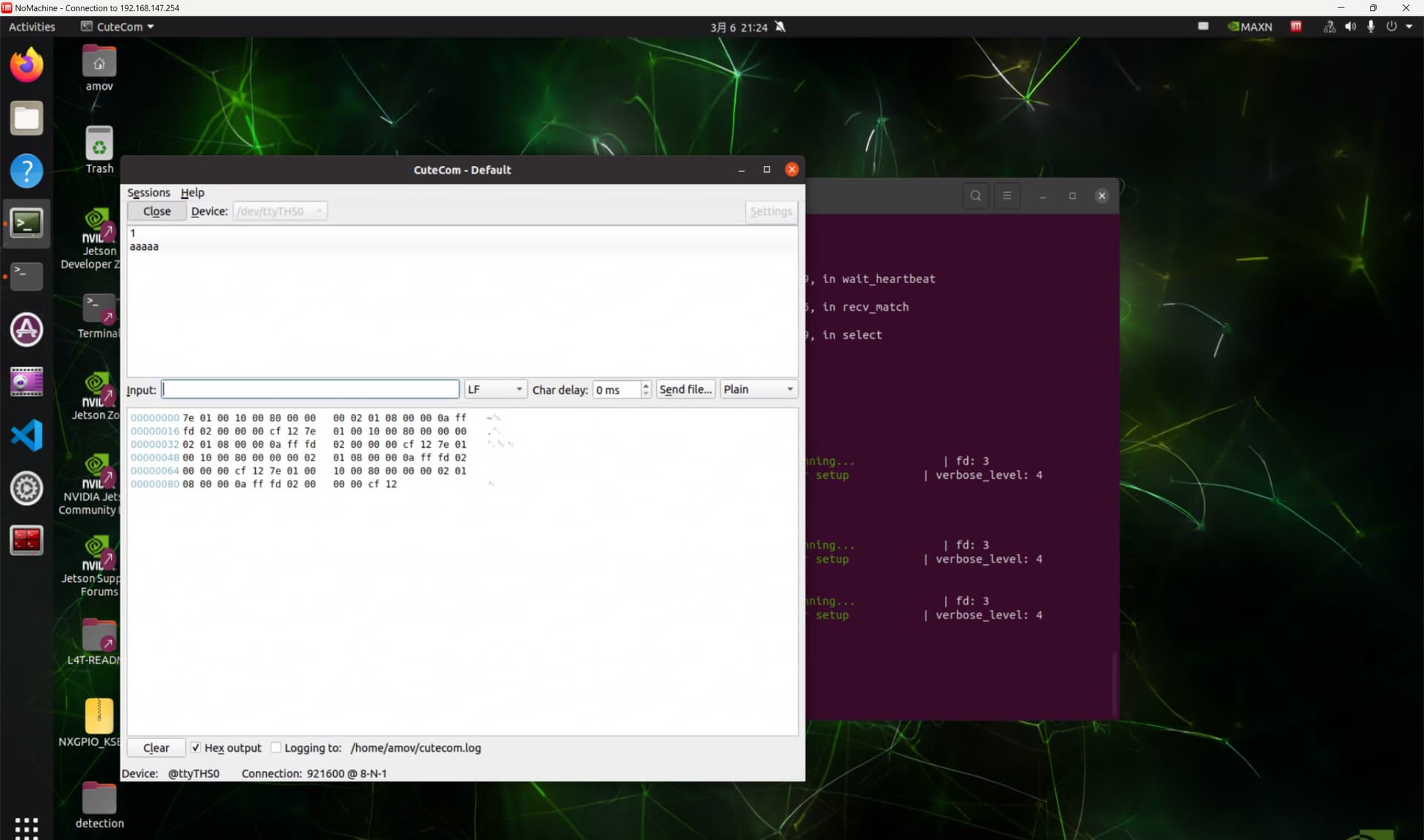

Check with serial connection
I ran cutecom to see the incoming data of /dev/ttyTHS0, then I got:
It seems like there are incoming data frames (starts with 7e 01 and ends cf 12) coming in with ~1hz. So I guess the wire connection was right.

I read this and tried to set Baud rates with TELEM2 to either 57600, 115200 and 1000000. All of them cause same result. The change of baud rate including these steps(115200 for example):
  • Change SER_TEL2_BAUD to 115200.
  • In MAVLink Console run uxrce_dds_client stop then uxrce_dds_client start -t serial -d /dev/ttyS1 -b 115200.
  • Reboot vehicle in QGroundControl.

Thanks for reply, @sibujacob & @tassalor1233! I’ve tried so many times with that connection and all failed. Then I used a USB-TTL adapter to connect TELEM2 on CubePilot Cube Orange+ to USB-A port on my companion computer and it worked! Turns out that it seems to be a issue of hardware or serial port (voltage) protocol? I am completely confused, but glad that I had one solution that works.
I think the thing is the UART1 port on my specific companion computer couldn’t communicate well with TELEM2 port on CubePilot Cube Orange+, but I couldn’t figure it out which side the problem was in.
