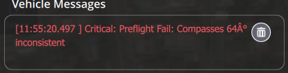

I am using QGroundControl with Pixhawk 2.4.8 for my F450 quadcopter. After the calibration process, the compass is showing compass x(number) A deg inconsitstent. For reference i have attached an external gps powered by Ublox 7m also i have tried to mount in different location also still i cant resolve the issue.
Also tried to calibrate the drone outside in the open space still same issue.
Thanks for reading
a) This is not really a QGroundControl issue. Rather a drone related issue and should be placed in such an appropriate category.
b) You didn’t supply any information regarding what system you are using. Is it PX4 or Ardupilot ? - What version?
c) a .bin file would be helpful to see what is going on
d) such problems are often related to wiring being close to FC. Especially wiring to motors or main wires from battery. Those can create a strong magnetic field and impact on the performance of any compass. –> Twist those sort of wires if possible. This can help to reduce impact from magnetic interference.

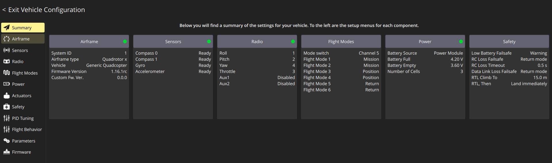

actually i am using PX4-1.16.1rc
what i tried and worked for me was disabling the COM_ARM_MAG to -1 (PS: I believe disabling this might have created some issue)

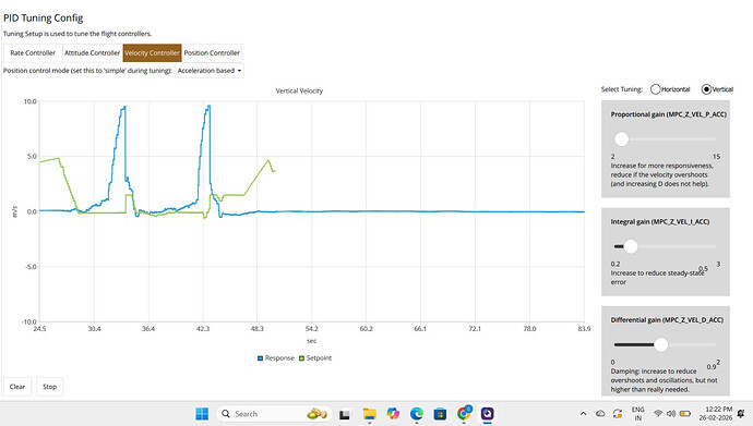

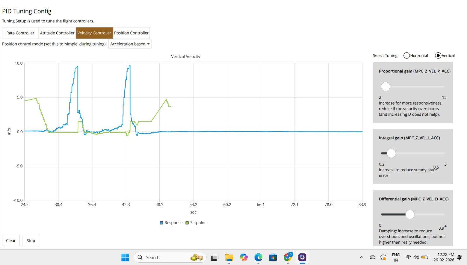

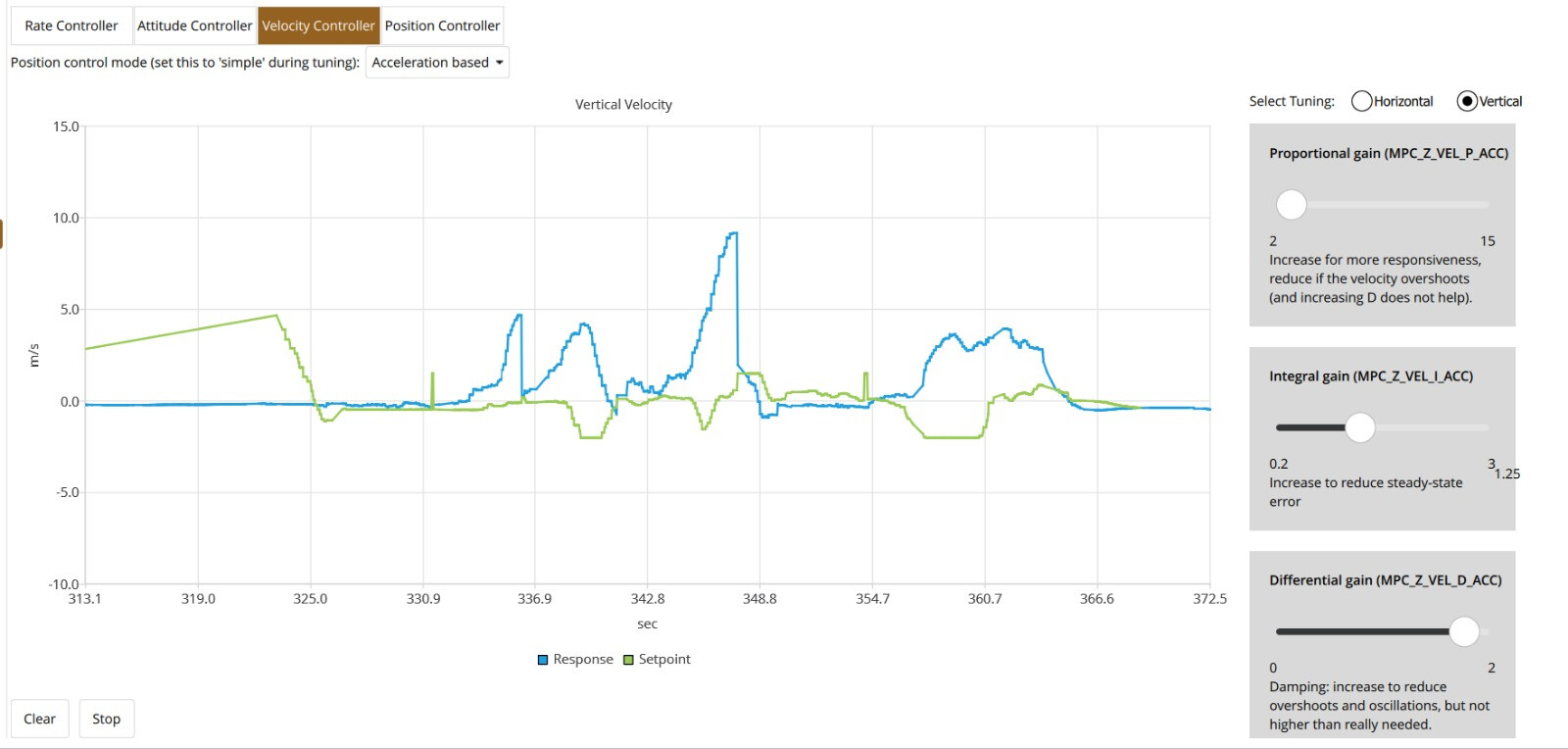

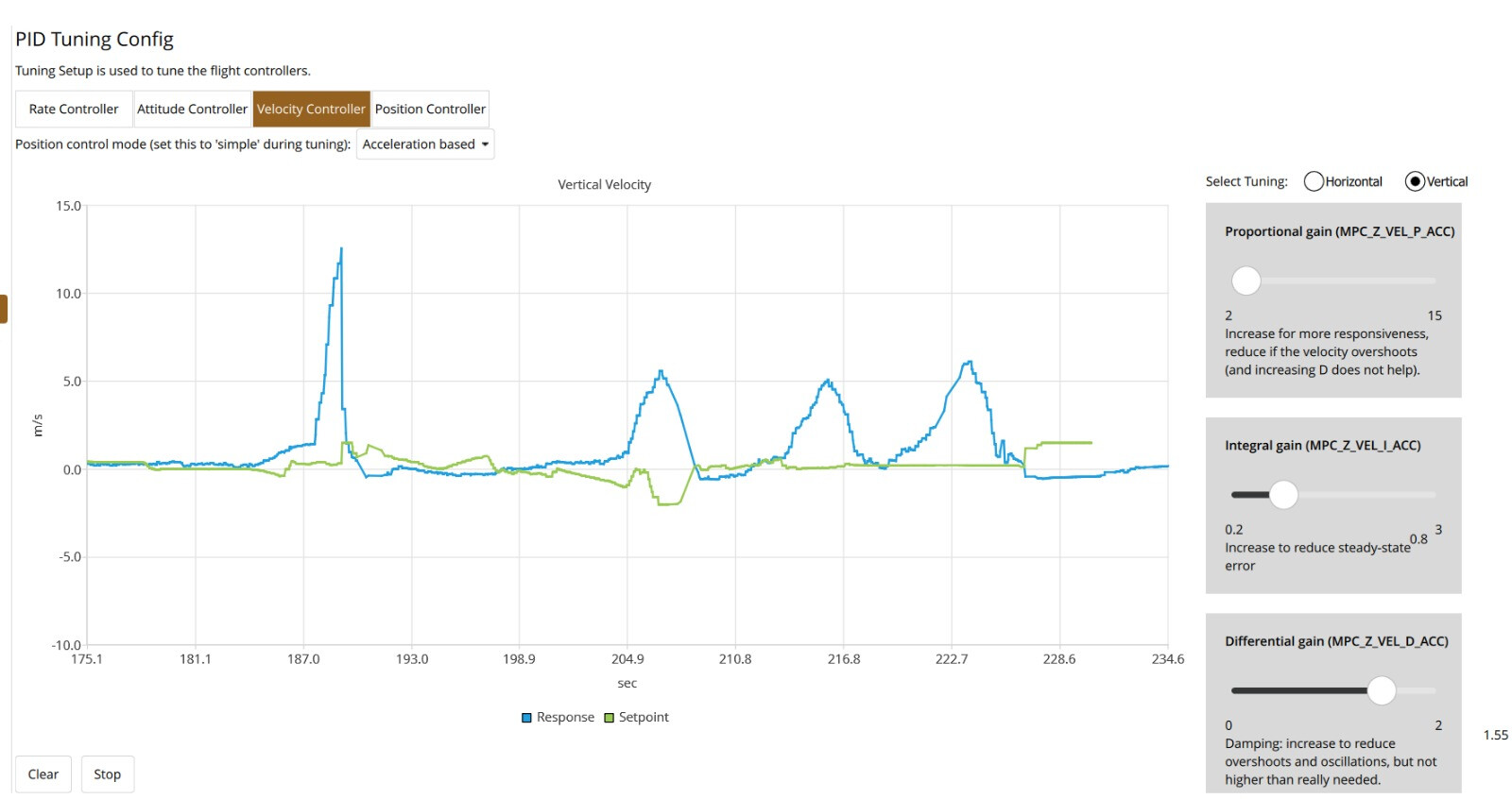

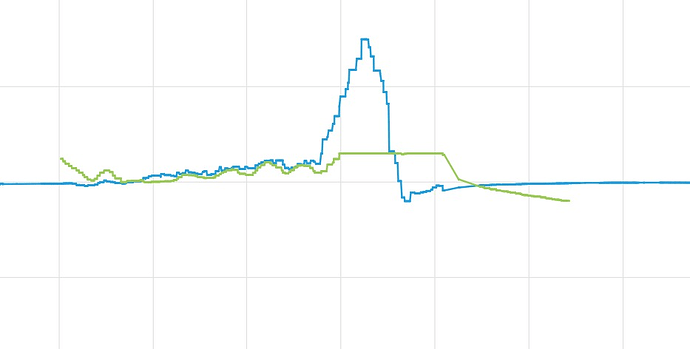

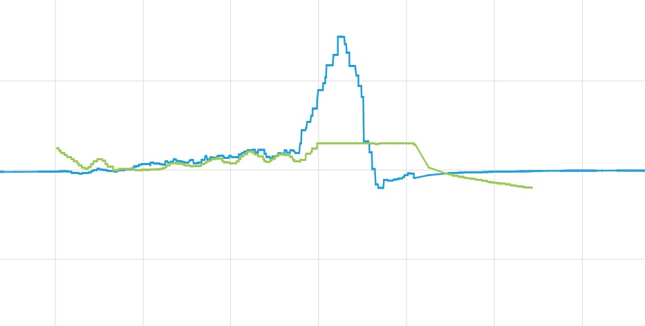

Still I am Facing an issue of response overshoots also i have tried different PID tuning method for vertical. is there any other way??
