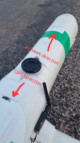

At first, before arming, I was getting a compass degree error (“Compass inconsistency by (some) degrees”).
To bypass this error, I hold the aircraft’s wings at a certain angle, arm it, and then put it back on the ground before switching to mission mode.
When the mission mode starts, the motors spin at a certain speed. However, at the takeoff point, the motors don’t speed up as expected and the elevators do not move upwards (to lift the aircraft).
When I connect the GPS in the reverse direction (as shown in the photo), the compass error disappears and the aircraft arms successfully while on the ground. The mission starts, but still, the expected behavior does not happen at takeoff.

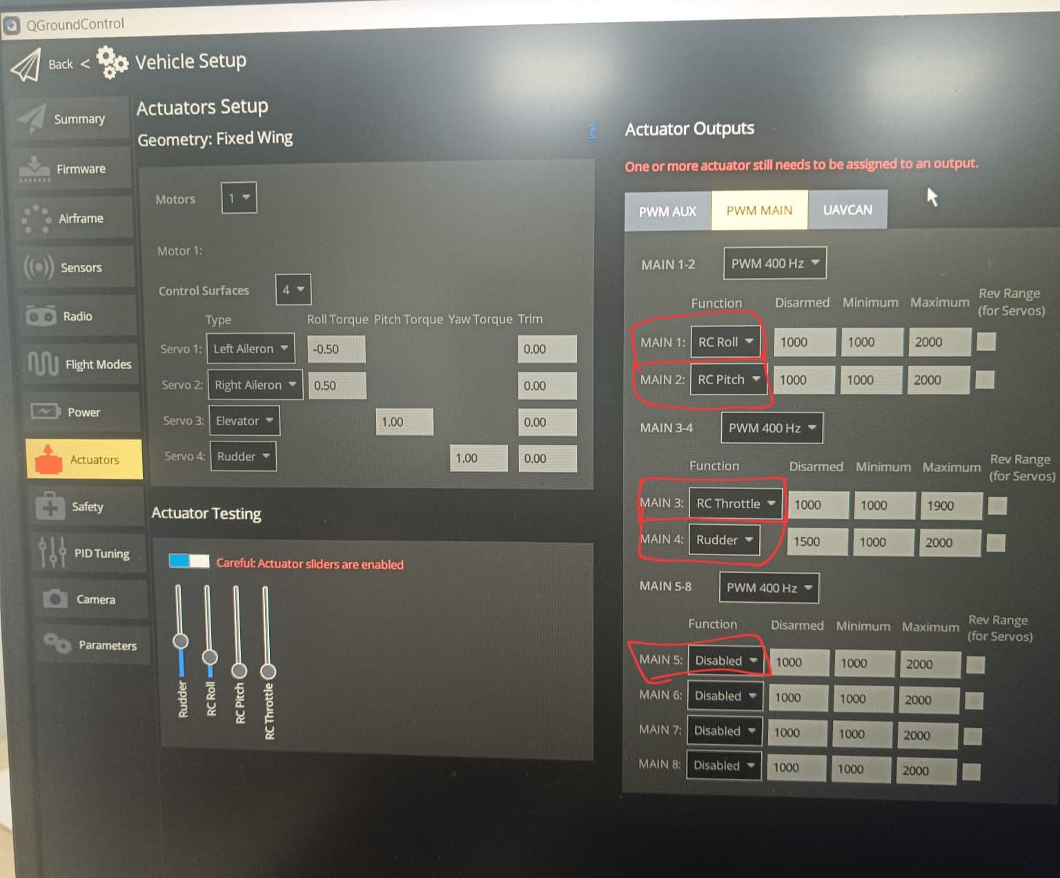

QGC Actuator tab settings:
Same as the second photo, but in order to get rid of the “One or more actuator still needs to be assigned to an output” error, I changed the actuator outputs as follows:
(Only the PWM MAIN section was changed)
MAIN 1: Left aileron
MAIN 2: Elevator
MAIN 3: Motor 1
MAIN 4: Rudder
MAIN 5: Right aileron
Cable connections:
MAIN 1: ailerons
MAIN 2: Elevator
MAIN 3: ESC
MAIN 4: Rudder
MAIN 5: No cable connected
