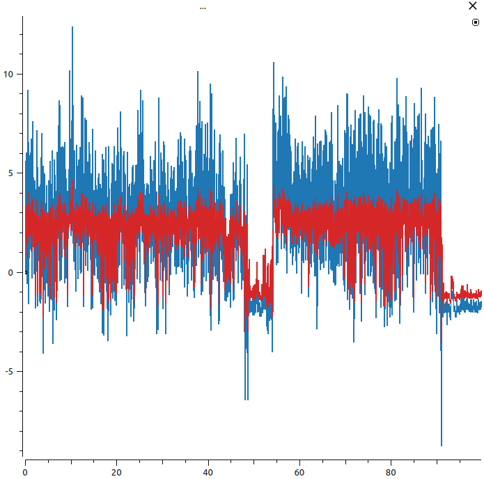

Thanks for your answer. Since my plane crashed and needs repairs before it can fly again, in the meantime, I’d like to ask if it’s normal for the airspeed sensor to show a negative spike at certain times when I test the airspeed sensor with the fan at home ?
red: ias
blue: differential pressure
Not uncommon to have negative differential pressure spikes yes. Especially around 0. These sensors are very sensitive around 0, once you build up airspeed the data generally looks much smoother.
Thank you for your answer, but I think that negative pulse is due to the sensor; there’s something wrong with the static holes. When I tried blocking 2 of the 4 holes, the signal was perfectly stable. Maybe I should buy a new sensor.
update: after i use new sensor, problem is solved!
