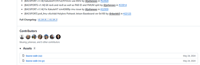

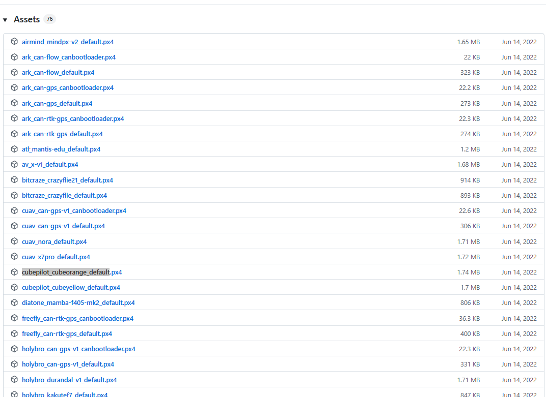

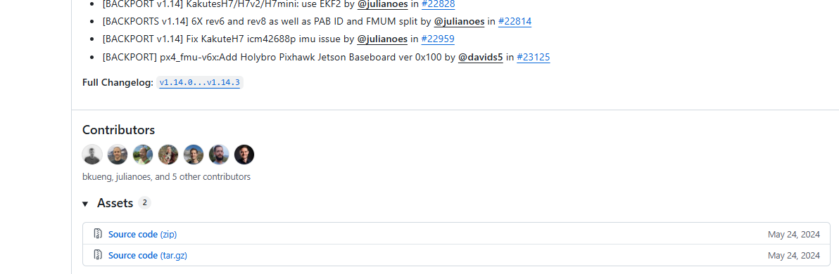

Hey, I have tried to download PX4 1.15.4 stable firmware for the cubeorange, and I can’t find the right file for it in the PX4-Autopilot-1.15.4 zip file 2 assets, while in older version 1.13.0 and below i see 76 Assets that I tried to upload a firmware and that did work, Can you provide a Guidnce on how to upload newer verson from 1.13.0 ?
1.13.0
1.14.3
Thanks, Yarden

The current way of handling this only keeps the latest stable on S3, overwriting the older one; we don’t have copies of older firmware.
I’m currently working on a proper firmware server that will replace the S3 bucket, and will keep every stable version; however, I’m not sure I will be able to build older releases.

not sure if you still need it. I just pulled it from http://ci.px4.io:8080/blue/organizations/jenkins/PX4_misc%2FFirmware-compile/activity/
You need to know release commit at Releases · PX4/PX4-Autopilot · GitHub.
So, for 1.15.4 commit is 99c4040
And the artifacts are at http://ci.px4.io:8080/blue/organizations/jenkins/PX4_misc%2FFirmware-compile/detail/v1.15.4/1/artifacts
