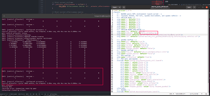

then in the px4 terminal, run commander takeoff and control_allocator status, but I got:
even without the string print?
thanks a lot for any advice!
