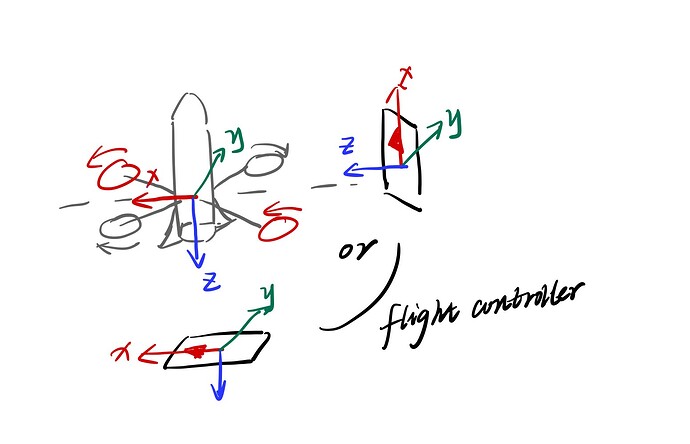

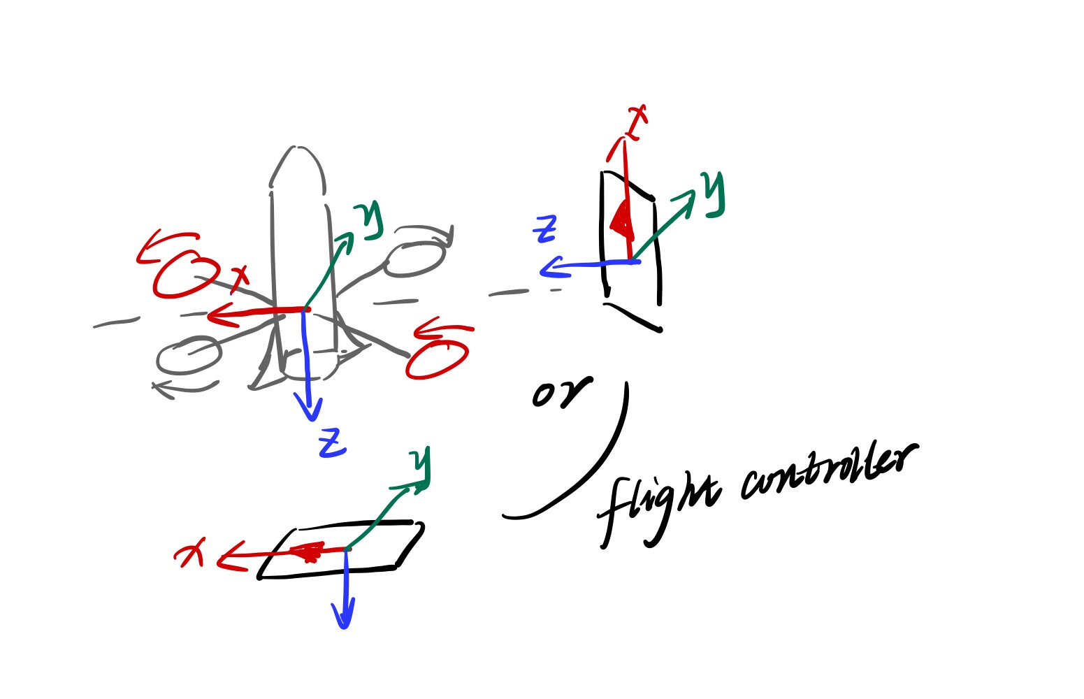

Excuse me!I am a newer to VTOL,which comfused me a lot is how to install the Pixhawk flight control system of tailsitter?For the Multicopter Mode, the Rotors Geometry is defined as ‘NED’,and in airframes file the CA_ROTORx_PX/PY prove this frame direction true. so if the Pixhawk Flight Controller is fixed in the Multicopter Frame or along the Fixed Wing Head Direction? And if I need to set the PX4 Param " SENS_BOARD_ROT" to switch the FMU direction?
Thanks a lot for reply !
I am sorry but your question is very confusing. Do you have pictures? Or send a email to khikmatov.farkhod@gmail.com
Have you solved this question?Im facing the same.
