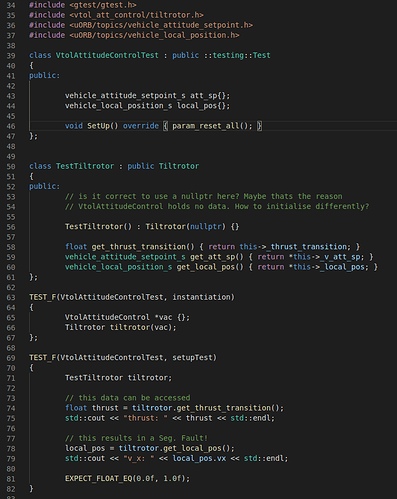

@jkflying I tried to write my own class to access the data which is stored in the VtolAttitudeControl class. Below you see a minimal compiling version:
This issue is now, that every time when I try to access data like _v_att from the VtolType class it results in a Seg. fault. I suspect that this data is not initialized yet due to the reason that I start my tiltrotor class with a nullptr. Could this be a reason? Or how do I get local pos and attitude (just an example)?
If you look in vtol_type.cpp you’ll see that the _local_pos is initialized from the attitude controller you pass in, which in your case is nullptr. You need to make an attitude controller that gets passed in to set these parameters.
I’m actually surprised it isn’t crashing earlier, when the _local_pos is set to the _attc->getLocal_pos(), given that _attc is nullptr.
@jkflying I understand what you are saying but I can still not figure out the correct way to initialize my VtolAttitudeControl class. I tried the forward declaration (as in many other px4 files) and the declaration with the #include like shown here.
Below you see the forward declaration. It compiles and runs but when trying to access _local_pos from the VtolAttitudeControl it ends in a seg. fault again. Valgrind says Use of uninitialised value of size 8, so it seems VtolAttitudeControl is still not initialized correctly.
When trying to use #include statement, it gives me following error message:
Any suggestions which of both ways to proceed? Or am I just missing a real obvious way to solve this?
Thanks,
You don’t need a forward declaration, that is only for places where you want a point to something as a class member but users of your public API don’t need access to it. Instead, you need to include the actual .h file.

You’re pretty close there, I got it to compile with just these tweaks:
diff --git a/src/modules/vtol_att_control/vtol_att_control_test.cpp b/src/modules/vtol_att_control/vtol_att_control_test.cpp
index 6fac62f79f..dfbc4bac0a 100644
--- a/src/modules/vtol_att_control/vtol_att_control_test.cpp
+++ b/src/modules/vtol_att_control/vtol_att_control_test.cpp
@@ -30,6 +30,7 @@
  * POSSIBILITY OF SUCH DAMAGE.
+#define MODULE_NAME "VTOL_ATTITUDE_TEST"
 #include <gtest/gtest.h>
 #include <vtol_att_control/tiltrotor.h>
@@ -68,7 +69,7 @@ public:
 TEST_F(VtolAttitudeControlTest, setupTest)
-       TestTiltrotor tiltrotor(_vtol_att_control);
+       TestTiltrotor tiltrotor(&_vtol_att_control);
        std::cout << "DEBUG ------------" << std::endl;
The test fails, but I’m sure that’s expected at this stage :+1:
