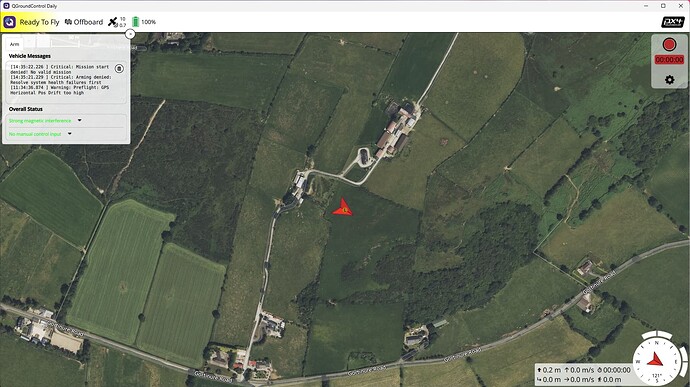

Greetings,
I tried to use python code and command 16, VehicleCommand.VEHICLE_CMD_NAV_WAYPOINT, to upload waypoints to agz_x500 drone.
The PX4 terminal says that command 16 is unsupported.
Is this not he way to upload waypoints to a drone?
PX4 output is below.

Is there anyone who can help me know how to upload mission waypoints in ROS2?
The examples out there are different; and everything I try fails.
I am running PX4 with QGC in python.
The vehicle is gz_x500
The error that I keep getting is no valid mission, or fix system errors.

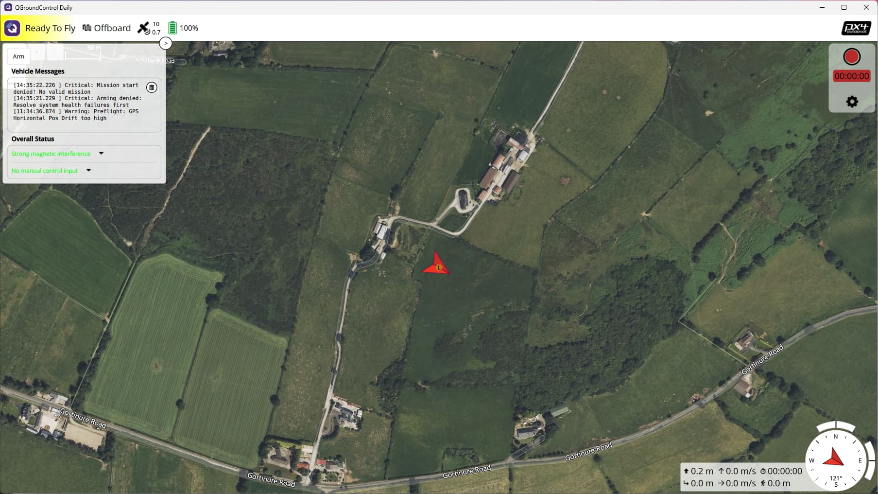

In the PX4 terminal I have these messages, among others
WARN [commander] Arming denied: Resolve system health failures first
WARN [commander] command 16 unsupported
