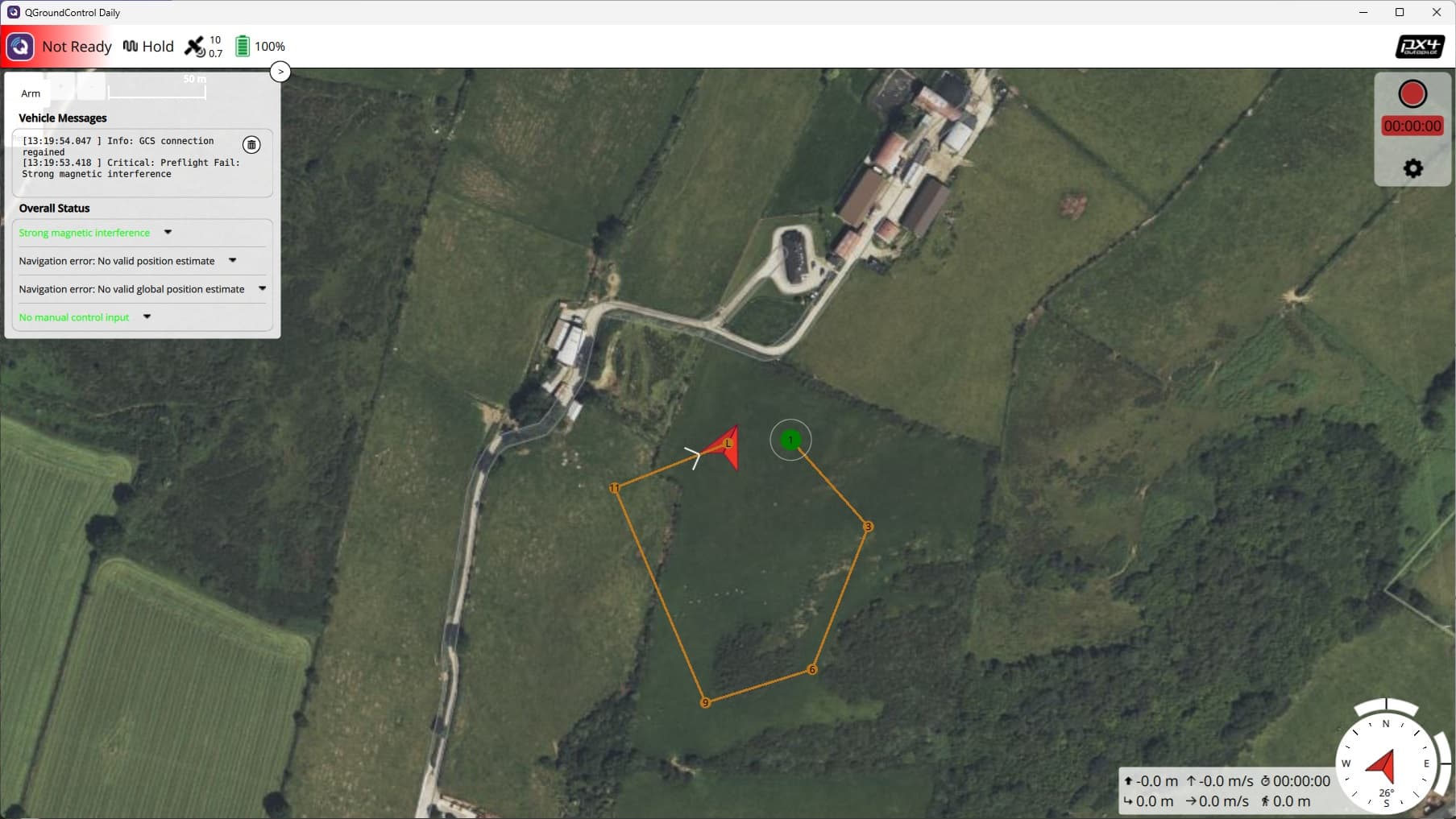

SITL Drone Cannot Fly Due To QGC Not Ready Status
Steps that I completed
  1. Started QGC
  2. make px4_sitl gz_x500 (in separate terminal)
  3. Run shell script to re-center map to Ireland (in another terminal)
  4. Run micro-xrce-dds-agent udp4 -p 8888 (in another terminal)
  5. in dir to run python code I did the following
  6. source /opt/ros/jazzy/setup.bash
  7. colcon build
  8. source install/local_setup.bash
  9. ros2 run proj_name node_name
QGC is in not ready status and the python code ends up doing nothing
The python code is trying to fly a mission in ROS2
The mission was previously run using MAVSDK, and upon completion the flight plan waypoints were kept on the vehicle.
So, the vehicle has waypoints, but the code that works if the QGC is in ready state does not work because the QGC is in a not Ready state

WARN [health_and_arming_checks] Preflight Fail: ekf2 missing data
WARN [health_and_arming_checks] Preflight Fail: No connection to the ground control station

WARN [health_and_arming_checks] Preflight Fail: Strong magnetic interference
WARN [health_and_arming_checks] Preflight: GPS Horizontal Pos Drift too high

WARN [commander] Arming denied: Resolve system health failures first

WARN [commander] Mission start denied! No valid mission

The issue is likely that you are moving the lat/lon very far after the EKF has already initialized at the default lat/lon. Gazebo doesn’t yet support non-default lat/lon, you will need to change the lat/lon in the default.sdf world file to your location in Ireland
That may be true.
Today I implemented your suggestion to recenter the map in the startup script, and that error has not shown up.
The error is intermittent, so time will tell
On another note, I keep getting command 16, 18 and 19 are unsupported.
So, I am unable to upload waypoints in ROS2
(MAV_CMD_NAV_WAYPOINT, MAV_CMD_NAV_LOITER_TURNS, MAV_CMD_NAV_LOITER_TIME)
Are those commands unsupported or could that error be caused because I am missing something?
How are you uploading waypoints? Are you using mavros or your own implementation? Are you trying to upload a mission? Have you seen the docs for missions?

I have read the links above, and am going through them again.
Are there any python examples of how to upload waypoints to a vehicle in mavros?
I have the uploading of mission waypoints working in mavsdk.
And, once the mission is loaded onto the vehicle, I can fly it using python code in mavros.
I cannot figure out how to upload the points onto the vehicle using python and mavros.
I found the mission_test.py file in the PX4 installation, but it seems to be based on python2.
I can send code snippets if that would help.
I am using the gz_x500 drone flying in px4 and using QGC.
