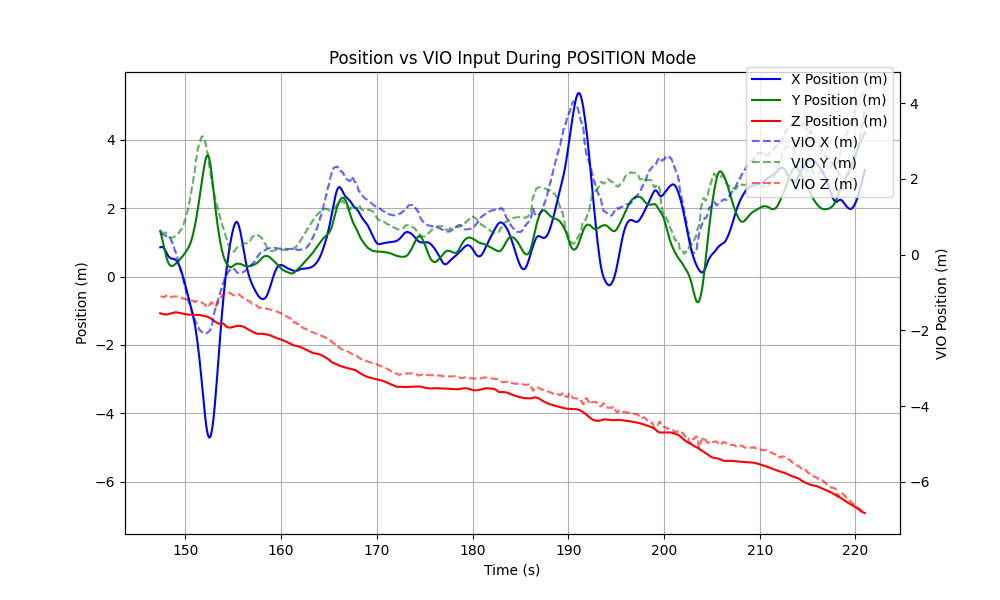

I’m using VIO data through ROS and the Pixhawk Cube enters POSITION flight mode, but does not hold position. Can anyone tell me why this might be from the following two flight logs?

  • Position Control Not Consistently Enabled: During the POSITION mode period, flag_control_position_enabled was disabled for a majority of the time (113 instances vs. 37 enabled). This suggests that even though the system was in POSITION mode (nav_state = 2), the position controller was not actively maintaining the vehicle’s position for significant portions of the flight.
  • Incomplete VIO Fusion: While external vision position data (cs_ev_pos) was fused into the estimator, velocity data (cs_ev_vel) was not. Velocity feedback is critical for position hold, as it helps dampen movement and correct drift. Without it, the controller cannot effectively stabilize the position.
  • Significant Positional Drift: The vehicle drifted substantially (X: 10.08 m, Y: 4.96 m, Z: 5.87 m) during the POSITION mode period, confirming the failure to hold position despite valid position estimates (xy_valid and z_valid).

flag_control_position_enabled is a runtime status flag within the vehicle_control_mode uORB topic.
When this flag is false, the autopilot will not attempt to hold its X-Y position, even if you’ve commanded POSITION mode. Our goal is to understand why it’s false and get it to turn true.
Why the flag is false in your logs?
VIO quality = 0
The quality field in the MAVLink ODOMETRY message is zero through the entire flight. PX4 treats that as “vision not trustworthy” and discards the sample before it ever reaches the controller.

Investigate your VIO system directly. Why is it outputting quality 0? Check its console output, logs, or any specific diagnostic tools it provides (e.g., ZED SDK, Realsense Viewer, etc.). This might indicate poor tracking, an uninitialized state, insufficient environmental features, an internal error, or simply that the quality metric isn’t being properly generated by your VIO ROS node.
