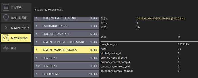

I want to control the gimbal using mavros, but I’m having some trouble now. I can currently control the gimbal using the QGC gimbal tool, but when I try to control it using mavros, I publish the topic “/mavros/gimbal_control/manager/set_attitude”, but the gimbal doesn’t respond. I wonder where the problem lies? Here are my configuration screenshots and the data from the mavlink detector, when I publish the topic, I can see that the detector has GIMBAL MANAGER SET ATTITUDE, but the gimbal doesn’t respond, and the angle display in the gimbal toolbar doesn’t change either.
The following is my command to publish ros topic, can you help me see where there is a problem or the setting is wrong。
ros2 topic pub /mavros/gimbal_control/manager/set_attitude mavros_msgs/msg/GimbalManagerSetAttitude "{target_system: 255, target_com
ponent: 190, flags: 30, gimbal_device_id: 1, q: {x: 0.0, y: -0.7069846987724304, z: 0.0, w: 0.7072288393974304}, angular_velocity_x: 0.1, angular_vel
ocity_y: 0.1, angular_velocity_z: 0.1}"
I’m assuming this is a PWM connected gimbal? Can you verify that mavros is working when connected to PX4?
Sorry I didn’t make it clear, this is a pwm gimbal。mavros is running properly。After a few days of trying, I found that I did not send the MAV_CMD_DO_GIMBAL_MANAGER_CONFIGURE command to configure gimbal-manager. When I use service: / mavros/gimbal_control/manager/configure to configure primary_control_sysid = 1, after primary_control_compid = 191 (onboard computer), I can pass the service: /mavros/gimbal_control/manager/pitchyaw to control gimbal. But I still can’t control it with topic: /mavros/gimbal_control/manager/set_pitchyaw.
