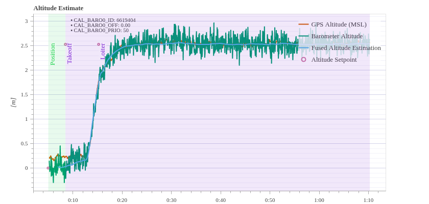

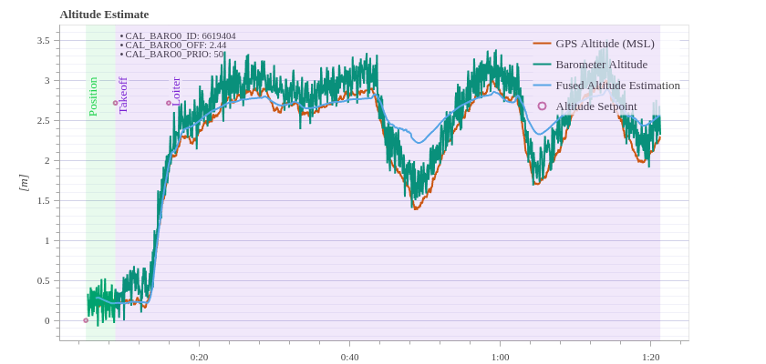

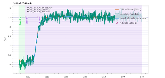

I’ve been working on setting up a swarm simulation (3x x500 drones) in Gazebo (Harmonic). I moved from using the standard make px4_sitl gz_x500 command to manually launching the PX4 binaries and Gazebo server/client in separate terminals.
The Problem
When I launch a single drone using the standard developer command: make px4_sitl gz_x500 …everything works perfectly. The flight is smooth, and the Real Time Factor stays above 98%
However, when I try to replicate this manually (to split the server/client or run multiple instances) using the exact same binary:
Bash
# Terminal 1
PX4_GZ_MODEL_POSE="0,0,0" PX4_SYS_AUTOSTART=4001 PX4_SIM_MODEL=gz_x500 HEADLESS=1 ./build/px4_sitl_default/bin/px4 -i 0
# Terminal 2
gz sim -g
…the drone immediately exhibits “bobbing” behavior (oscillating up and down) and the logs have sporadic: ERROR [sensors] Accel #0 fail: TIMEOUT!
And
WARN [health_and_arming_checks] Preflight Fail: High Accelerometer Bias
Notifications
When running 3 drones the bobbing behaviour becomes worse. My Hardware usage doesn’t seem to be an Issue, CPU usage stays below 60% (there is no individual core that has higher usage than the others) and my GPU also stays below 40%. Ram is below 50% usage.
Using- PX4_GZ_MODEL_POSE=“0,0,0.3” PX4_SYS_AUTOSTART=4001 PX4_SIM_MODEL=gz_x500 HEADLESS=1 ./build/px4_sitl_default/bin/px4 -i 0
Using - make px4_sitl gz_x500
My Question
How do I spawn multiple drones without the oscillating altitude? My final objective is to have three drones fly a basic leader-follower mission, but I need to get the three drones hovering reliably before I can do that.

I do the same (launching gz sim and then px4’s binary) in this tmuxinator template and I don’t observe this issue: I would maybe double check that the world.sdf opened by default by gz-sim and the one opened by default by make px4_sitl (I think in the airframe romfs) have the same physics, plugins, etc.
Thank you, I have implemented a method similar to the template and my simulation has improved. Two drones can now maintain a stable hover. Introducing a third drone causes instability again, but that must be due to hardware limitations I am assuming. Three drones with RTF=0.8 works smooth.
