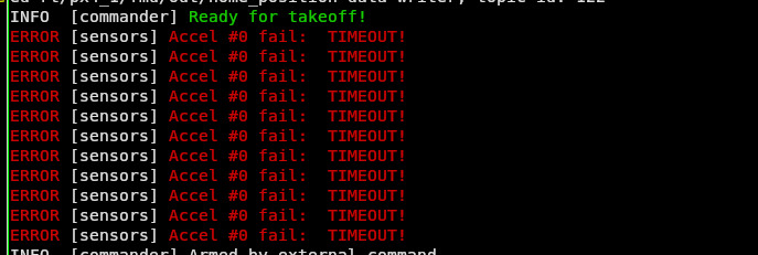

We are preparing for a competition related to Swarm UAVs as a team. The question I’m about to ask may not be very specific to PX4, but if anyone has encountered this issue and found a solution, I would greatly appreciate your help.
I am using ROS2, Gazebo Harmonic, and uXRCE-DDS (PX4-ROS 2/DDS Bridge). I am starting 3 drones in Gazebo. They communicate with each other via uXRCE-DDS. Gazebo is started in HEADLESS mode and I monitor it through QGroundControl. However, I am constantly receiving the error:
Accel #0 fail: TIMEOUT!
Because of this, I am not getting the expected results in the simulation, and the UAVs are behaving erratically due to issues with the accelerometers. I have tried increasing the threshold for the accelerometer in the QGroundControl parameters, but I still receive the same error, and the 3 drones behave very erratically in the simulation. I am using the latest version of px4_msgs.
Additionally, I have tried running it as PX4_STANDALONE, but the problem persists.
I would be very grateful if you could help with this issue.
