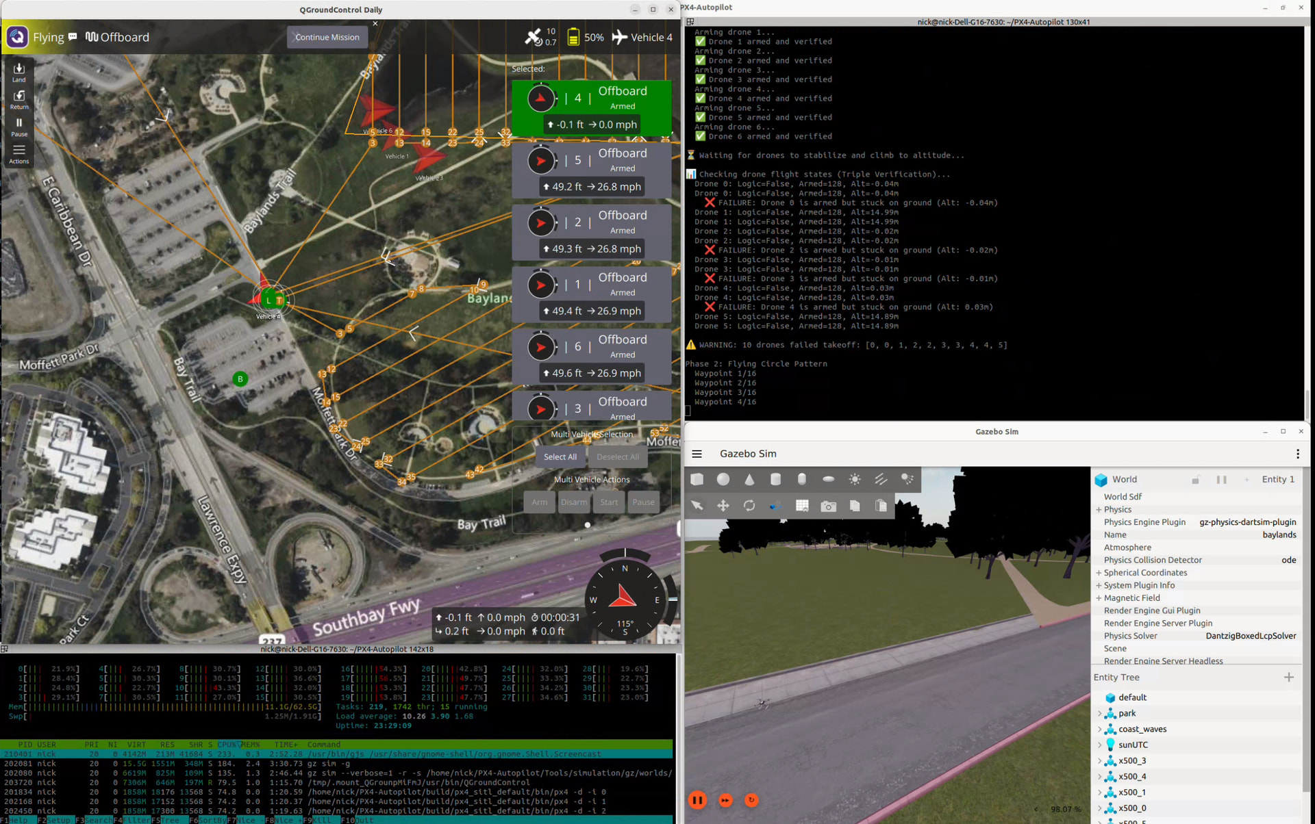

Hi. I am trying to control a large number (6-10) of gz_x500 quadcopters using python and a PX4 + Gazebo SITL. With 10 drones usually 7-8 take off and 2-3 stay on the ground. The show as flying in QGC.
I am using commit 56327284672bb0bc721edad39d67d6f51900bf17 of PX4-Autonomy which was committed 12/16/2026 along with Gazebo Harmonic 8.10 on Ubuntu 22.04.
I’m using a bash script called start_drones.sh to create 10 SITL instances and attach them all to the same Gazebo instance. A python script circle_flight.py then commands them all to fly in a circle formation using offboard mode. Usually 7 or 8 drones takeoff and fly the mission successfully. Most of the time the 9th and 10th drones fail to take off but in QGC it says they are flying.
I am running this on a laptop with 32 CPU cores, a NVIDIA 4080 GPU which I confirmed is being used by Gazebo, and 64GB of RAM. My load average is between 6 and 12 during the test.
I have tried:
Enabling GPU, confirm its working with nvidia-smi
Put Gazebo into headless mode
Setting PX4_SIM_SPEED_FACTOR to 0.5
Checking for failed MAVLINK messages using mavlink_stats.keys()
Allowing 60 seconds for the EKFs to converge initially
Is this a known issue when running large numbers of drones? Is it likely this is a system resource issue?
Sounds like you’re pushing the boundaries here…
So how exactly do they fail? Do they not take off at all? Or do they take off but the visualization is wrong? Do they take off looking at the logs, or printfs?
Thanks for the quick response. Here is a screenshot of a 6 drone test. You can see in QGC that vehicle 4 is still at the launch site but it says its flying and in offboard mode. In gazebo the drone you can see partially on the sidewalk is vehicle 4. All the other drones successfully took off and flew the route properly and then landed. For some reason vehicle 4 is almost always the one that doesn’t take off with my 6 drone test. For a 10 drone test its almost always drones 9 and 10 but it varies.
What’s the debug/console output for them?
Here is the output from a recent trial I did with 6 total drones. This output is from drone 2 which did not take off

Hey Shoe Marker.
I did something very similar to what you dod several times with no issues. But only After making minor adjustmetns to the PX4 I found a major issue had to do with the Gimbal model. I only got networked Gimbaled drones working after significant work on the config files for the camera. I can’t remember anymore what I had to do…..and it was a defense thing so I could not share with you the solution anyway. I reached the conclusion it was a waste of time anyway since the networked drone device and the vision of these drones was more easily solved by seperating the problem alltogether.
do you have the issue when you spawn the 10 nodes as generic GZ500?
I have been launching only gz_x500 drones, not the gz_x500_gimbal
look for namspace / mavlink ID
Sorry I can’t explain this better but there is an ID for the namespace for each drone and then there is the mavlink ID itself in the simulator. I recall I had to make sure the start up script had to make a unique of each. I also had ot ensure the UDP/TCP ports I communicated on are unique.
On occasion the simulator bugs out…especially with the camera model. it is for the same reason the camera links were not set up with multi agent systems in mind.
Turning off ekf2_mag_check worked and now all 10 drones take off. The drones were failing to have the ekf2 converge because of the magnetometer.
