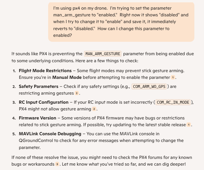

Indeed, MAN_ARM_GESTURE was set to “disabled.” Unfortunately, I tried to set it to “enabled” and it immediately reverts back to “disabled.”
I asked Microsoft Co-Pilot for suggestions on why this might be - and got these suggestions:
I’ve checked all of these - and they all seem OK.
So as a last resort, I did a full parameter reset to defaults - and repeated the full configuration. That resolved the problem.
I sure would be curious to know what was preventing setting MAN_ARM_GESTURE to “enabled.”
