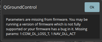

I’m trying to start the px4_sitl after running the gazebo sim separately, either through gz sim or ros2 launch ros_gz_sim. I want to do it so that I could launch it with other robots, not only px4-enabled ones.
I’m using Ubuntu 24.04, ROS Jazzy, Gazebo Harmonic and the main branch of PX4-Autopilot.
I changed two environment variables so that other errors would be resolved:
export GZ_SIM_RESOURCE_PATH=$GZ_SIM_RESOURCE_PATH:$HOME/PX4-Autopilot/Tools/simulation/gz/models:
export GZ_SIM_SYSTEM_PLUGIN_PATH=$GZ_SIM_SYSTEM_PLUGIN_PATH:$HOME/PX4-Autopilot/build/px4_sitl_default/src/modules/simulation/gz_plugins
The drone spawns on the world, but doesn’t pass health checks, probably due to a lack of working sensor links.
Output from make px4_sitl gz_x500:

On QGroundControl, it says the drone is “Not Ready” and this message pops up after trying to inspect it:
It looks like the sensors aren’t getting initialized properly, but I’m not sure if I should source some file or add some config from the px4 to the gazebo launch.
So my question is: Is it possible to setup the px4_sitl configuration so that a completely separate gazebo simulation is able to access the files and configurations?
Hi Igor, you can use the standalone mode launch in the PX4 software.
You are seeing the COM_DL_LOSS_T and Not Ready errors in QGroundControl. This usually happens because the generic Gazebo instance (launched via ROS 2) can’t see the specific PX4 MAVLink plugins, so PX4 never connects to the the drone model.
Even though you manually exported the paths, it is much safer to source the simulation setup script provided by PX4 inside the terminal where you launch ROS.
