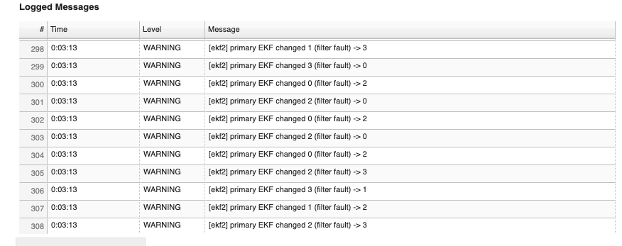

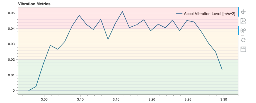

Have a look at your logs. I had really high vibrations on my UAV.
In V12 Multi-EKF was enabled for some boards by default. I haven’t taken a deep dive into this topic so take this with a grain of salt, but here’s what it does as far as I understand it:
This functionality looks at the state of the IMU during the flight. If vibrations get too high it switches to a different IMU. If there is a mismatch between both IMUs (?) the quad does a small jump or twitch. Back in V11 this only happened before the flight. With EKF2_MULTI_IMU enabled in V12 it can now happen during the flight as well. You can spot this beaviour by looking at your logged messages:
To fix this problem you can set the Parameter EKF2_MULTI_IMU" to 1. This stops the IMU from switching midair. What you should do first instead is fixing the vibrations on your quad. I put a lot of effort into this, but it still wasn’t enough in the end.
