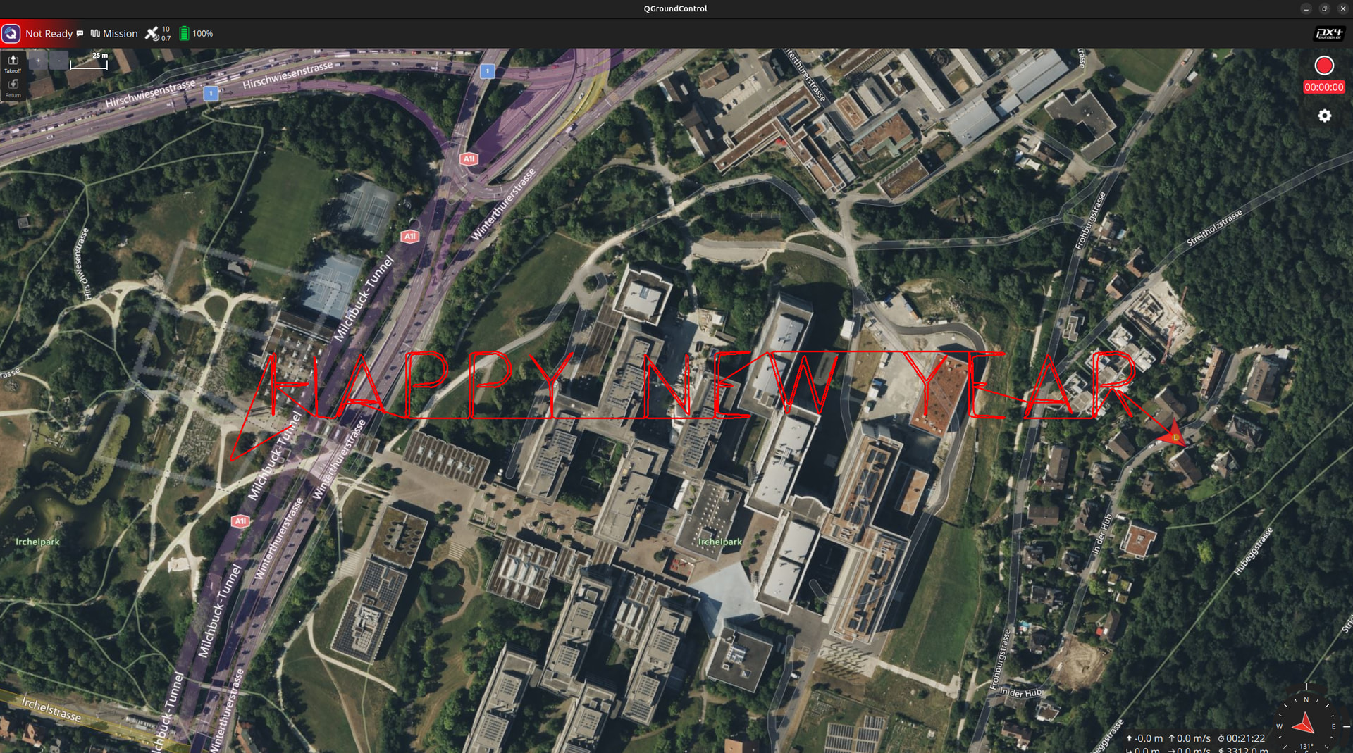

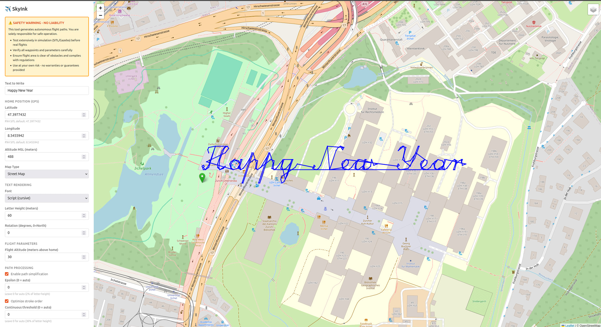

Example: “HAPPY NEW YEAR” Mission
These screenshots show the tool generating a “HAPPY NEW YEAR” mission - seemed fitting to share this on New Year’s Eve!

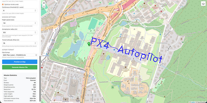

  • Interactive Web GUI - Real-time map preview with adjustable parameters
  • Multiple Export Formats - .plan, KML, CSV, GeoJSON, .waypoint
  • Configurable Parameters - Acceptance radius, flight altitude, speeds, fonts

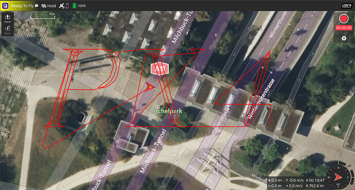

Hey @farhang thats a funny project, have you done any flight testing yet? have you considered battery life, or any other physical constraints of a vehicle?
@rroche Thanks,
I have not flight tested it outside except SITL. The Battery estimation however can be calculated based on the estimated mission time. The mission estimated time has the shape of letters (tajectory) and velocity factors inside.
