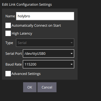

Im working with the orange cube plus and the holybro telemtry radio 433mhz. I cannt conect the qgroundcontrol (windows 11) using the telemetry radio. Also when I create serial comunication, it appears as conected but on main screen show disconnected and doesnt recieve any data from the cube, but I conect the cube directly to the pc by usb it works. Anyone can help me? Thanks.
Also check if SER_TEL1_BAUD is 57600. This setting works for me when using the telemetry radio.
