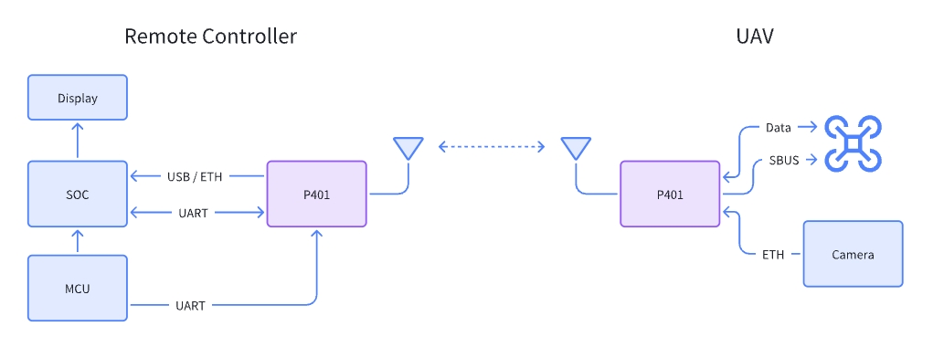

We have developed several high-performance image transmission modules (P401 / P301) and are seeking collaborators to co-develop an open-source, screen-enabled remote control solution tailored for the open-source community.
Are there any interested partners? ( wei.liu@cecooleye.cn)
This module features transparent transmission capabilities for serial and Ethernet ports, with a communication range exceeding 20 km. It supports multiple frequency bands including 900 MHz, 1.4 GHz, 2G, 5G, and 6G, making it highly suitable for drone applications

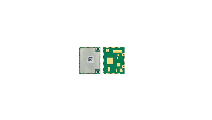

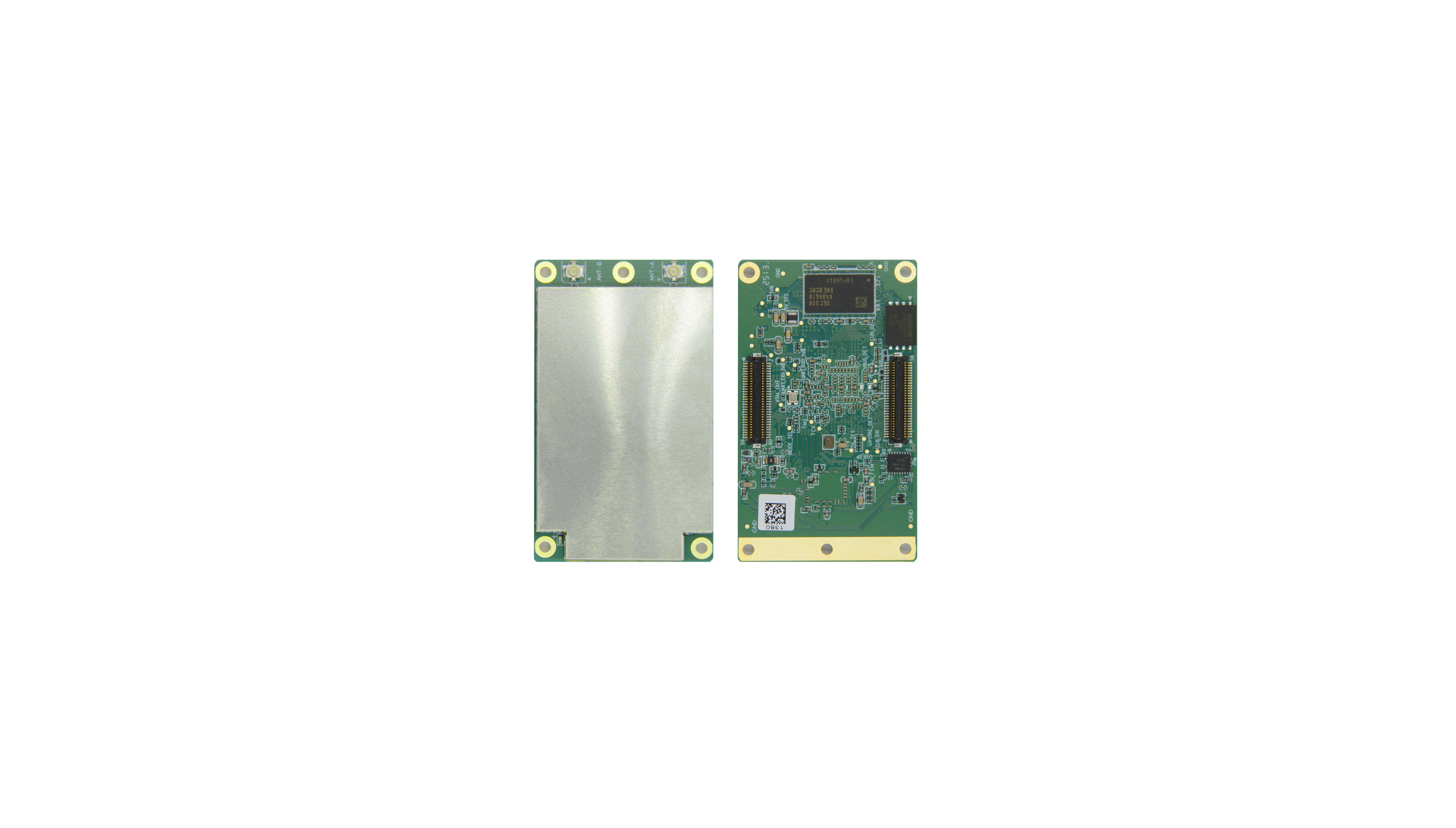

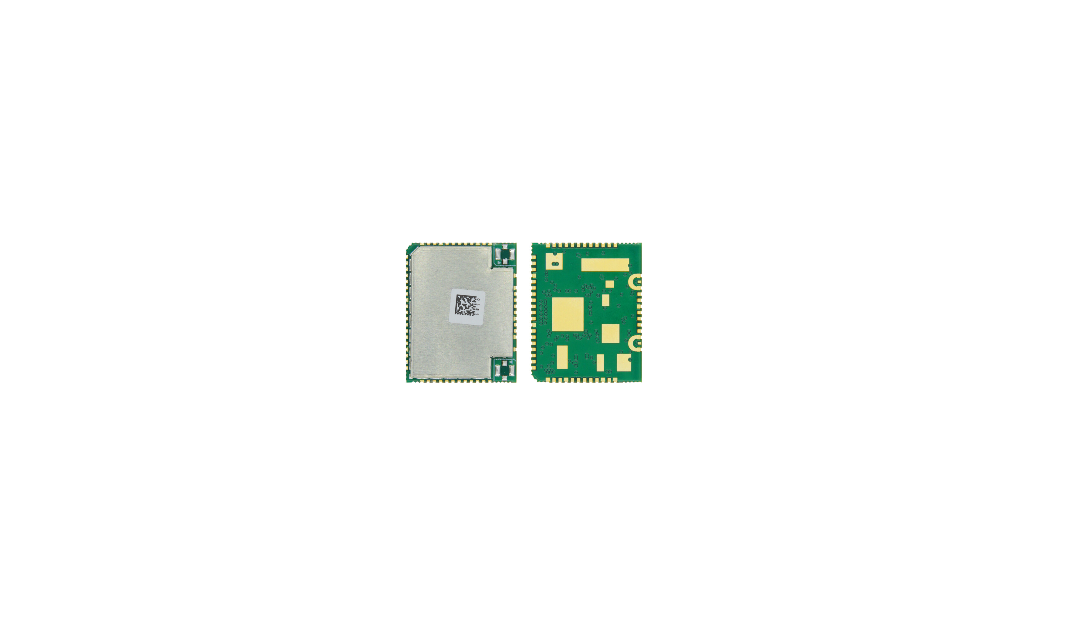

P401-D is a 0.9/1.4/2.4/5/6G dual-band high-bandwidth, high-power, 2x2MIMO wireless data transmission module. Based on the principle of TDD, it adopts key technologies such as OFDM and MIMO to improve frequency band utilization while providing longer transmission distance. It supports automatic frequency hopping and MCS independent dynamic adjustment, and has the advantages of long distance, strong anti-interference ability, and low latency. As a highly integrated module product, this product can be widely used in drone, security monitoring, wireless screen projection, wireless audio and video, special inspection and other fields, which can meet the needs of customers for rapid application development.
  • Based on the principle of TDD, key technologies such as OFDM and MIMO are adopted to improve bandwidth utilization.
  • Support modulation modes of 256QAM/64QAM/16QAM/QPSK/BPSK and independent dynamic adjustment.
  • Support 1.25MHz/2.5MHz/5MHz/10MHz/20MHz/40MHz channel bandwidth and autonomous dynamic adjustment.
  • Supports AES encryption and multiple security policies to prevent illegal monitoring and interception.
  • Using a frequency hopping scheme, real-time monitoring of interference conditions, automatic selection of frequency hopping range; automatically and quickly changing frequency points and adjusting modulation and coding strategies (MCS) based on the current channel interference situation.
  • Support star networking and relay networking, can build wireless multi-hop networking applications.
  • The maximum air interface transmission rate can reach 40Mbps.
