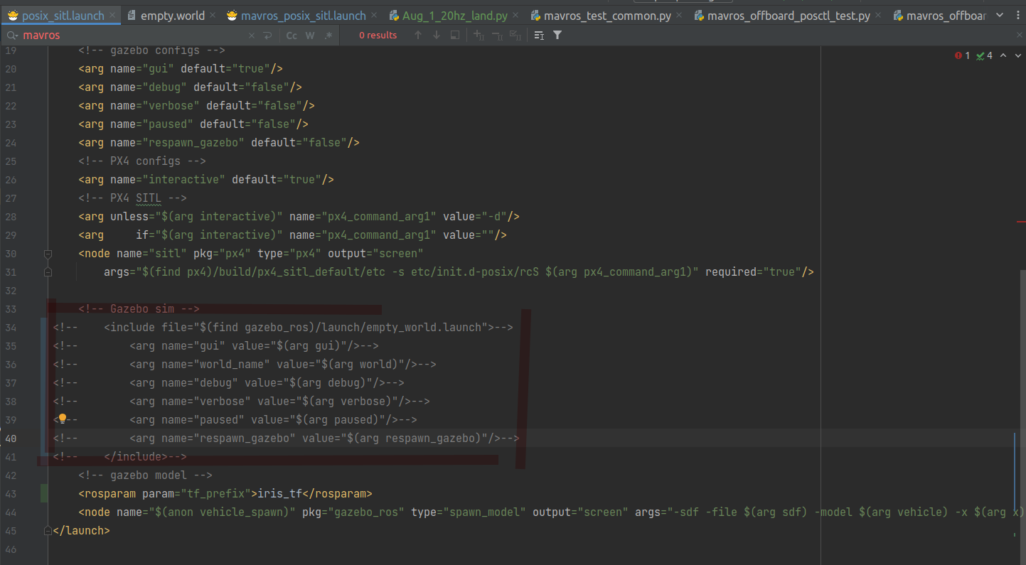

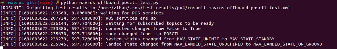

Roslaunch px4 mavros_posix_sitl.launch publish nothing but separately roslaunch empty.world and mavros_posix_sitl.launch work
In Ubuntu 20.04 noetic, why does the gazebo simulation suddenly cannot take off by offboard script.

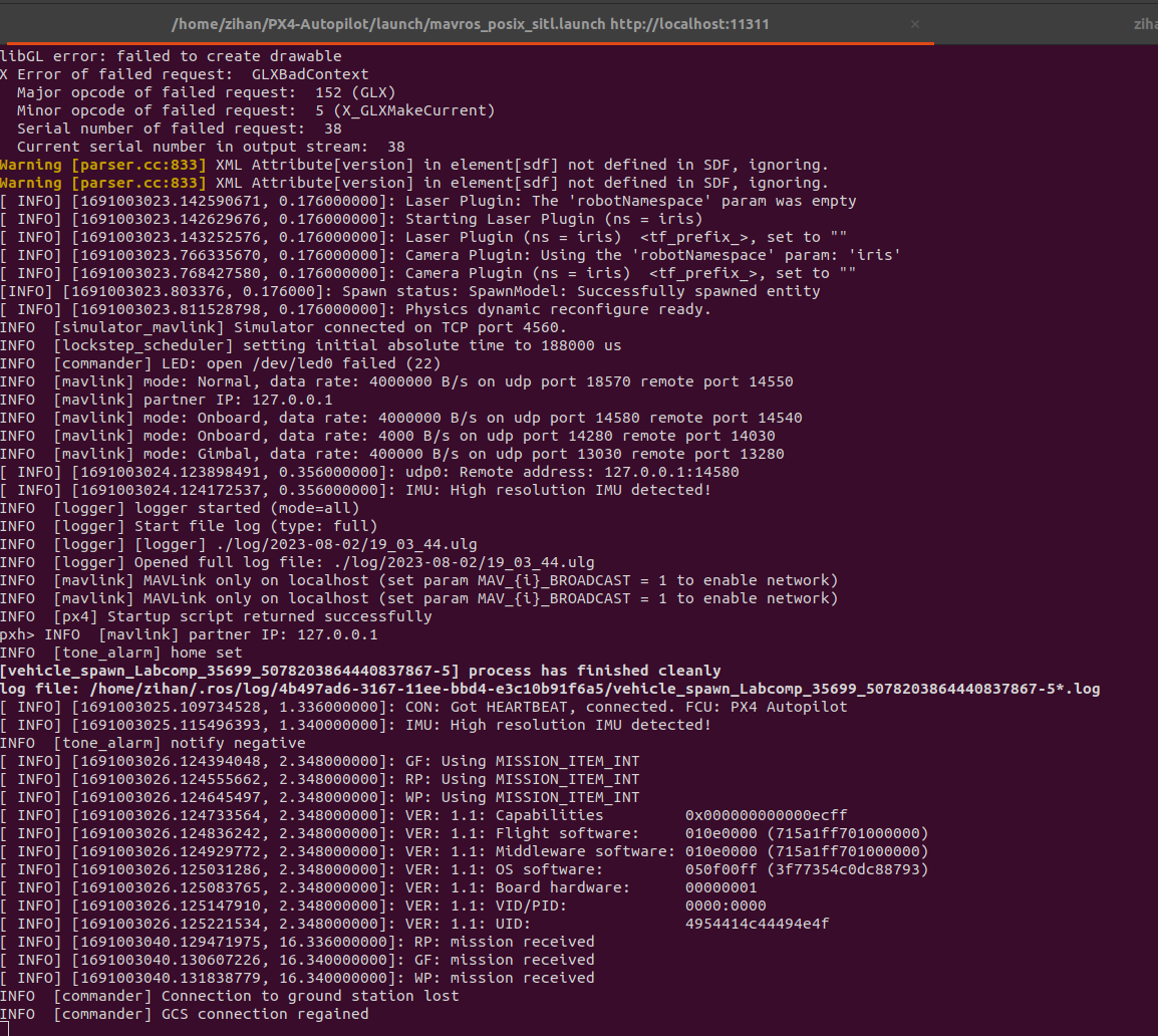

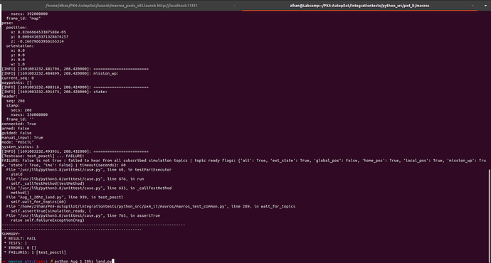

The mavros_posix_sitl.launch get stuck in the WP: mission received. it should show green word “read to fly” in the next line.
but it actually shows

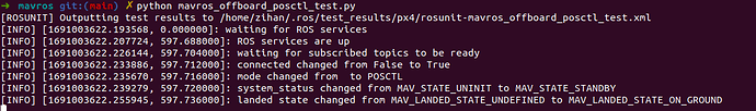

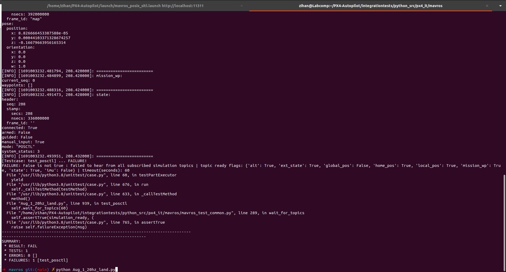

The offboard python script errors show the code gets stuck in
landed state changed from MAV_LANDED_STATE_UNDEFINED to MAV_LANDED_STATE_ON_GROUND
and shows the error ‘global_pos’: False,

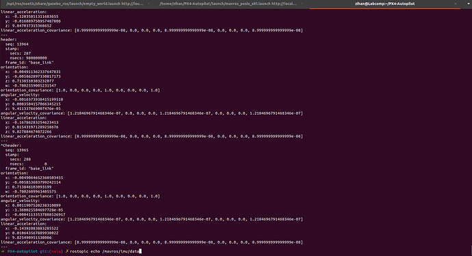

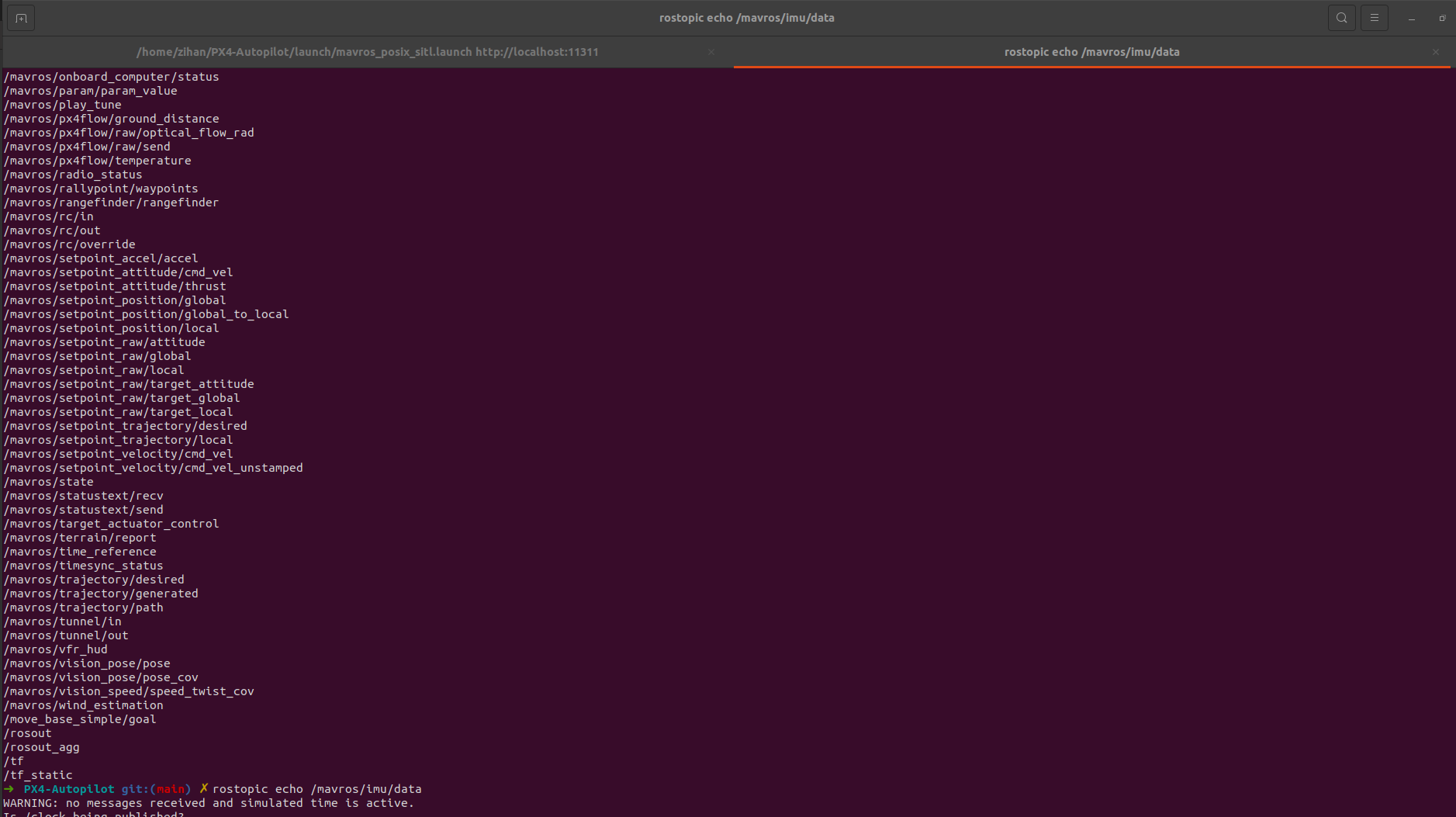

and then I found it does not publish any topic

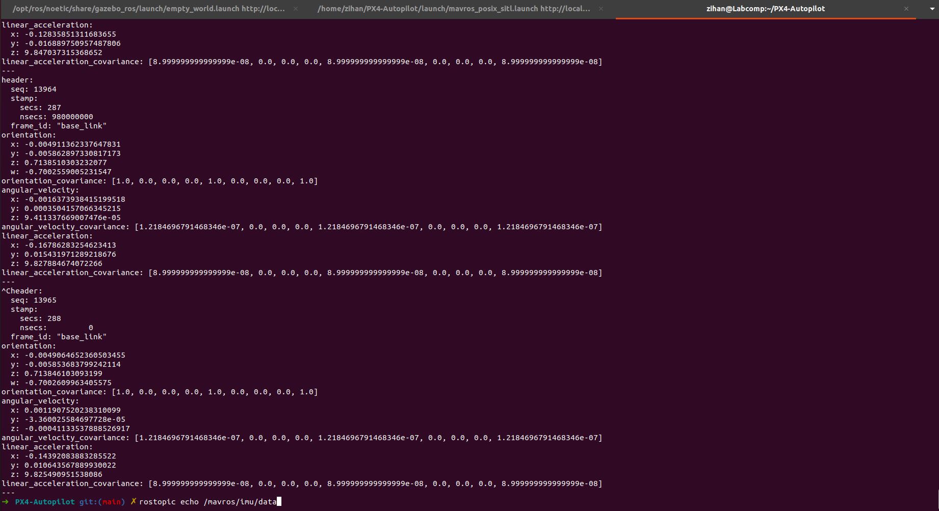

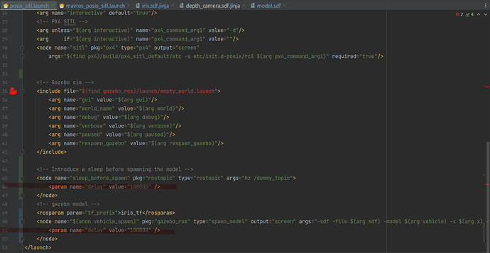

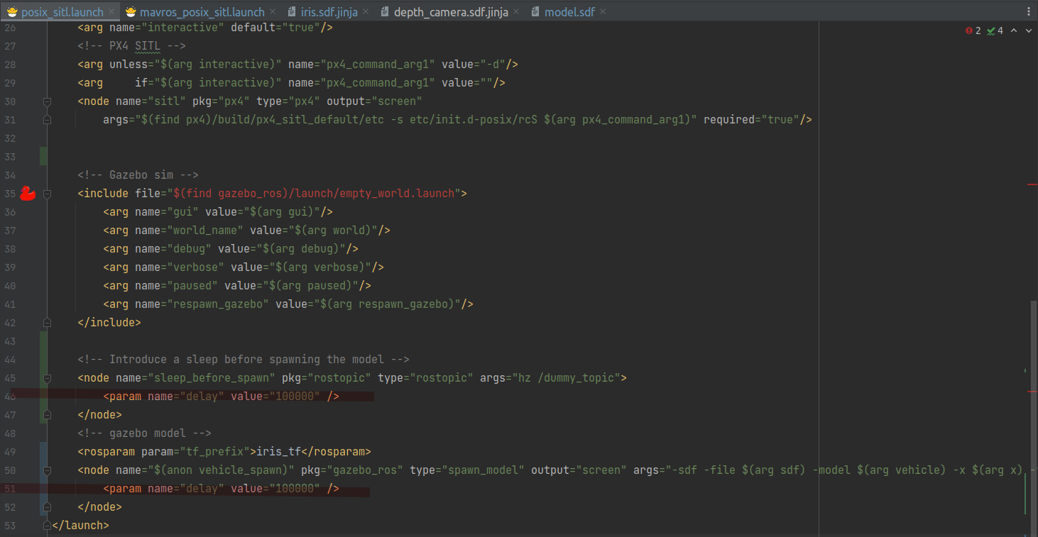

However, if I separate launch the empty_world.launch and “mavros_posix_sitl.launch”
for example
First launch , according to PX4 gazebo simulation
roslaunch gazebo_ros empty_world.launch world_name:=$(pwd)/Tools/simulation/gazebo-classic/sitl_gazebo-classic/worlds/empty.world
Second launch
roslaunch px4 mavros_posix_sitl.launch
Then there is no issue, all mavros can publish
There is the log when roslaunch px4 mavros_posix_sitl.launch with gazebo environment.
(do not publish any mavros topic)

[INFO] [1691005154.079991, 0.000000]: Loading model XML from file /home/zihan/PX4-Autopilot/Tools/simulation/gazebo-classic/sitl_gazebo-classic/models/iris/iris.sdf
[INFO] [1691005154.084317, 0.000000]: Waiting for service /gazebo/spawn_sdf_model
[ INFO] [1691005154.269889647]: Finished loading Gazebo ROS API Plugin.
[ INFO] [1691005154.270679662]: waitForService: Service [/gazebo_gui/set_physics_properties] has not been advertised, waiting...
[ INFO] [1691005154.308499562]: Finished loading Gazebo ROS API Plugin.
[ INFO] [1691005154.309333846]: waitForService: Service [/gazebo/set_physics_properties] has not been advertised, waiting...
[ INFO] [1691005154.801761124]: waitForService: Service [/gazebo/set_physics_properties] is now available.
[ INFO] [1691005154.815540810, 0.008000000]: Physics dynamic reconfigure ready.
[INFO] [1691005154.990254, 0.180000]: Calling service /gazebo/spawn_sdf_model
Warning [parser.cc:833] XML Attribute[version] in element[sdf] not defined in SDF, ignoring.
[INFO] [1691005155.304670, 0.376000]: Spawn status: SpawnModel: Successfully spawned entity
INFO  [simulator_mavlink] Simulator connected on TCP port 4560.
INFO  [lockstep_scheduler] setting initial absolute time to 388000 us
INFO  [mavlink] mode: Normal, data rate: 4000000 B/s on udp port 18570 remote port 14550
INFO  [mavlink] partner IP: 127.0.0.1
INFO  [mavlink] mode: Onboard, data rate: 4000000 B/s on udp port 14580 remote port 14540
INFO  [mavlink] mode: Onboard, data rate: 4000 B/s on udp port 14280 remote port 14030
INFO  [mavlink] mode: Gimbal, data rate: 400000 B/s on udp port 13030 remote port 13280
[ INFO] [1691005155.637932666, 0.552000000]: udp0: Remote address: 127.0.0.1:14580
[ INFO] [1691005155.638161379, 0.552000000]: IMU: High resolution IMU detected!
INFO  [logger] [logger] ./log/2023-08-02/19_39_15.ulg
INFO  [logger] Opened full log file: ./log/2023-08-02/19_39_15.ulg
INFO  [mavlink] MAVLink only on localhost (set param MAV_{i}_BROADCAST = 1 to enable network)
pxh> INFO  [mavlink] partner IP: 127.0.0.1
[vehicle_spawn_Labcomp_56040_2477356088420129964-5] process has finished cleanly
log file: /home/zihan/.ros/log/420e0658-316c-11ee-bbd4-e3c10b91f6a5/vehicle_spawn_Labcomp_56040_2477356088420129964-5*.log
INFO  [tone_alarm] home set
[ INFO] [1691005156.620308673, 1.532000000]: CON: Got HEARTBEAT, connected. FCU: PX4 Autopilot
[ INFO] [1691005156.621682034, 1.532000000]: IMU: High resolution IMU detected!
INFO  [tone_alarm] notify negative
[ INFO] [1691005157.631736873, 2.540000000]: GF: Using MISSION_ITEM_INT
[ INFO] [1691005157.631950287, 2.540000000]: RP: Using MISSION_ITEM_INT
[ INFO] [1691005157.632097887, 2.540000000]: WP: Using MISSION_ITEM_INT
[ INFO] [1691005157.632282860, 2.540000000]: VER: 1.1: Capabilities         0x000000000000ecff
[ INFO] [1691005157.632458383, 2.540000000]: VER: 1.1: Flight software:     010e0000 (715a1ff701000000)
[ INFO] [1691005157.632582836, 2.540000000]: VER: 1.1: Middleware software: 010e0000 (715a1ff701000000)
[ INFO] [1691005157.632720685, 2.540000000]: VER: 1.1: OS software:         050f00ff (3f77354c0dc88793)
[ INFO] [1691005157.632797336, 2.540000000]: VER: 1.1: Board hardware:      00000001
[ INFO] [1691005157.632863521, 2.540000000]: VER: 1.1: VID/PID:             0000:0000
[ INFO] [1691005157.632929137, 2.540000000]: VER: 1.1: UID:                 4954414c44494e4f
[ INFO] [1691005171.637655456, 16.532000000]: GF: mission received
[ INFO] [1691005171.638085100, 16.532000000]: WP: mission received
[ INFO] [1691005171.638300786, 16.532000000]: RP: mission received
There is the log when roslaunch px4 mavros_posix_sitl.launch and roslaunch empty.world ( gazebo environment) separately.
( publish all mavros topics)

Try to add delay before spawn model but it still does not work
