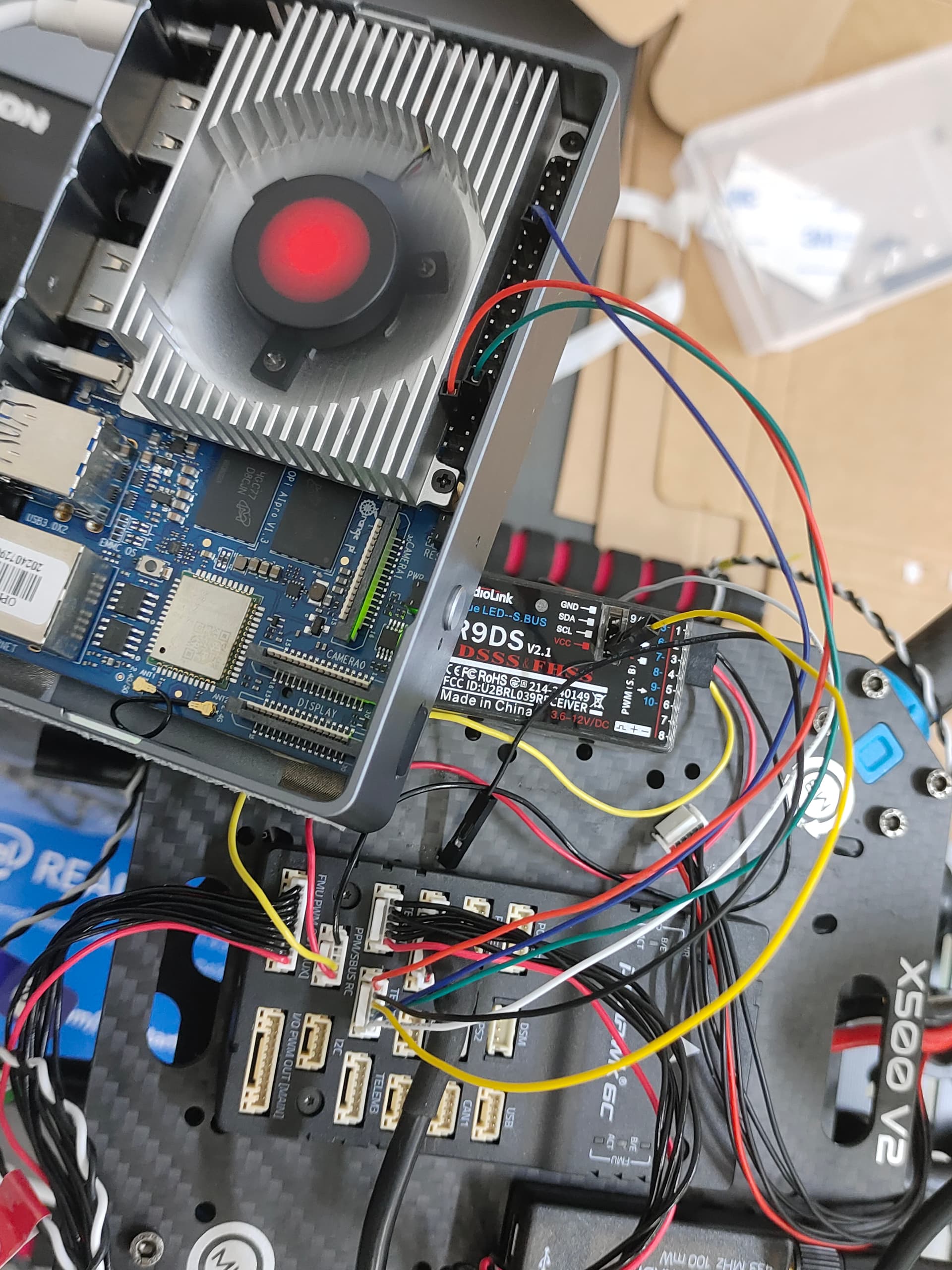

Here is my wiring diagram (5V, RTS, and CTS are not connected),I’ve confirmed that the RX, TX, and GND wiring is correct.

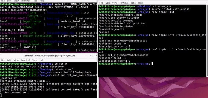

Launching the Agent:
HwHiAiUser@orangepiaipro:~/Desktop$ sudo LD_LIBRARY_PATH=/usr/local/lib MicroXRCEAgent serial --dev /dev/ttyAMA2 -b 921600
[sudo] password for HwHiAiUser:
[1752753332.685699] info     | TermiosAgentLinux.cpp | init                     | running...             | fd: 3
[1752753332.686226] info     | Root.cpp           | set_verbose_level        | logger setup           | verbose_level: 4
[1752753333.429373] info     | Root.cpp           | create_client            | create                 | client_key: 0x00000001, session_id: 0x81
[1752753333.429485] info     | SessionManager.hpp | establish_session        | session established    | client_key: 0x00000001, address: 1
[1752753333.448333] info     | ProxyClient.cpp    | create_participant       | participant created    | client_key: 0x00000001, participant_id: 0x001(1)

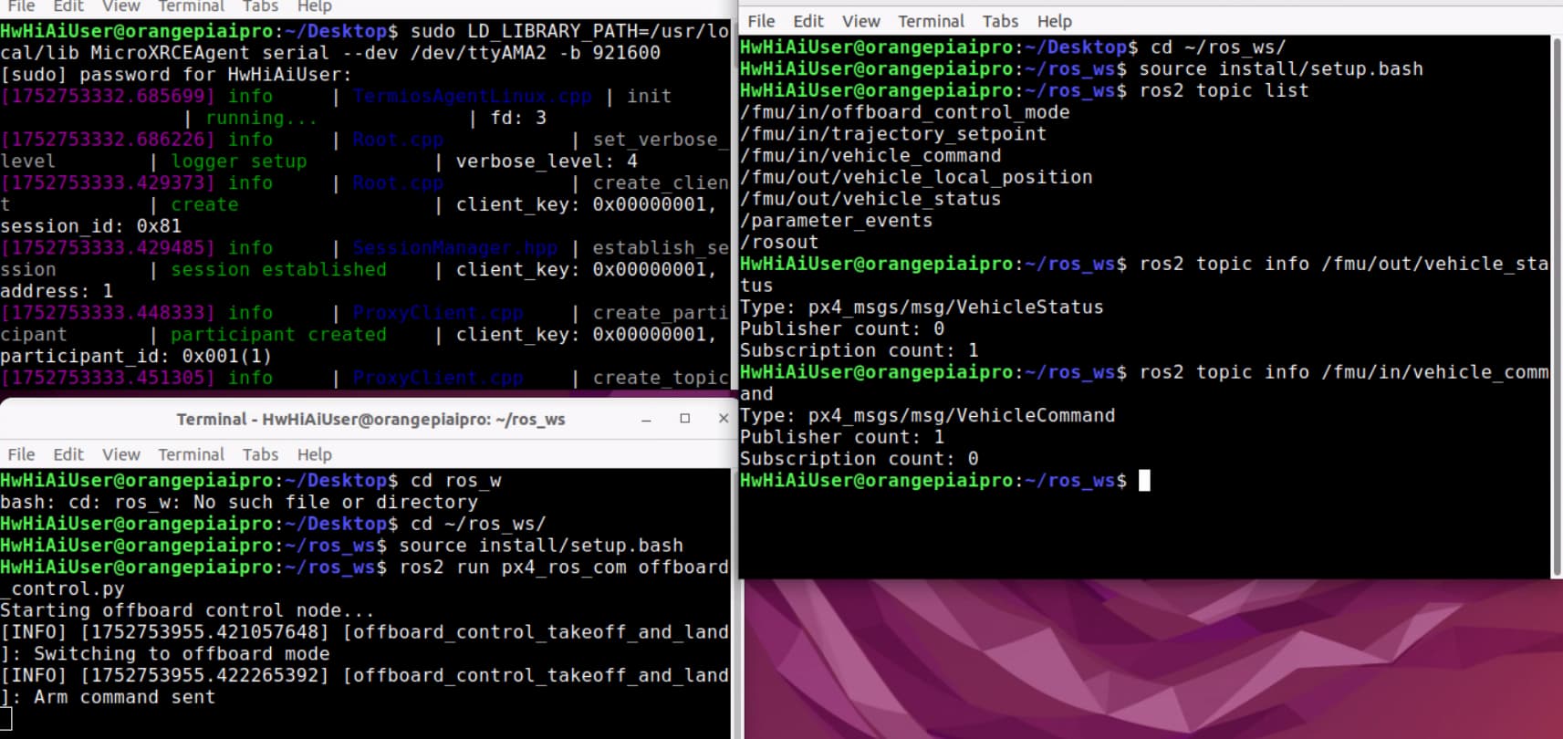

This is the result of my ROS2 run:

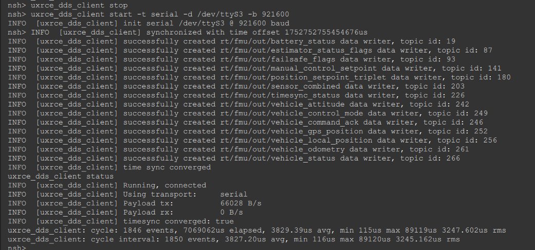

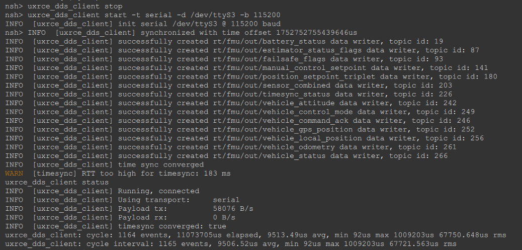

I also manually started the client at different baud rates, but the ROS2 results were the same.
I’d be grateful for any advice you might have.
