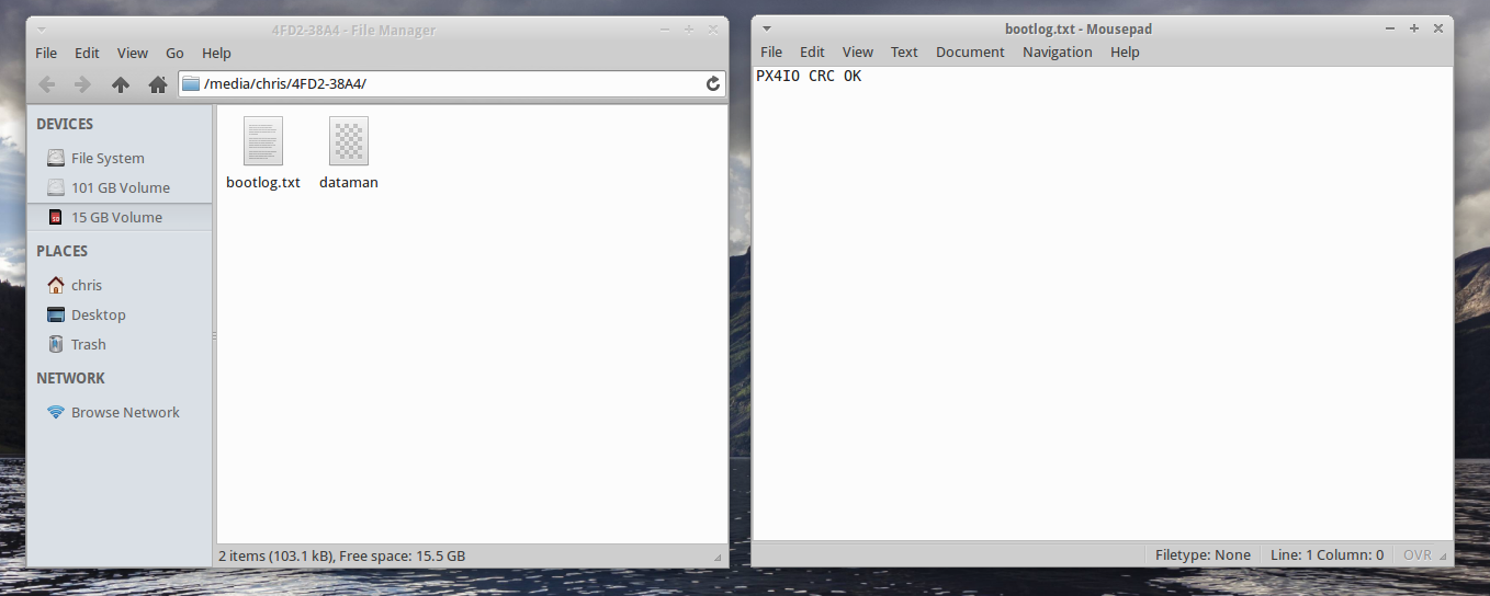

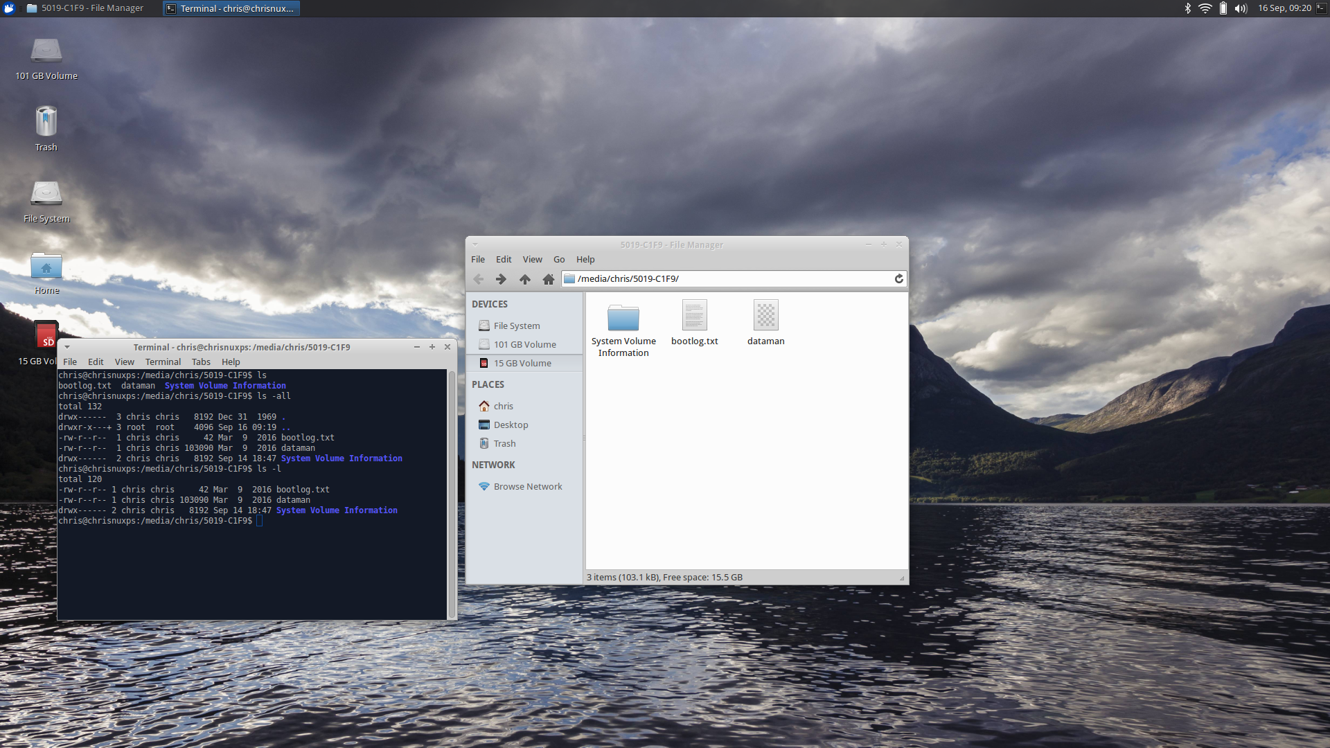

I’ve tried two different cards (both freshly formatted to fat32). The only files created are bootlog.txt and dataman (with no extension). QGroundControl’s log download widget also shows that there are no log files (even after actually flying my quad).
