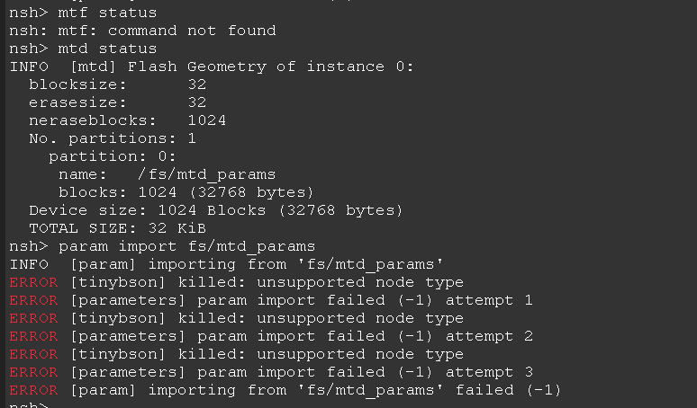

I made a flight control board by myself and ported the official PX4 code. The version is V1.15.4. During the testing process, I encountered an error. The error message is as follows:

INFO [param] selected parameter default file /fs/mtd_params
INFO [param] importing from ‘/fs/mtd_params’
WARN [parameters] ignoring unrecognised parameter ‘CAL_ACC0_P?’
ERROR [tinybson] killed: unsupported node type
ERROR [parameters] param import failed (-1) attempt 1
ERROR [parameters] param import failed (-1) attempt 2
ERROR [parameters] param import failed (-1) attempt 3
ERROR [param] importing from ‘/fs/mtd_params’ failed (-1)
ERROR [init] param import failed
[bsondump] reading from /fs/mtd_params
BSON document size 5196114
ERROR [bsondump] failed (-1)

INFO [param] importing from ‘/fs/microsd/parameters_backup.bson’
INFO [parameters] BSON document size 719 bytes, decoded 719 bytes (INT32:24, FLOAT:11)
INFO [parameters] summary: 0/1640 (used/total)
INFO [parameters] file: /fs/mtd_params
INFO [parameters] storage array: 35/1640 elements (288 bytes total)
INFO [parameters] storage array (custom defaults): 0/1640 elements (256 bytes total)
INFO [parameters] auto save: on
param: export: 0 events, 0us elapsed, 0.00us avg, min 0us max 0us 0.000us rms
param: find: 37 events
param: get: 0 events
param: set: 36 events, 265us elapsed, 7.36us avg, min 1us max 13us 1.839us rms
dmesg [47:100]
INFO [param] selected parameter backup file /fs/microsd/parameters_backup.bson
Could someone please help me figure out the reason for this problem? Thank you very much.
