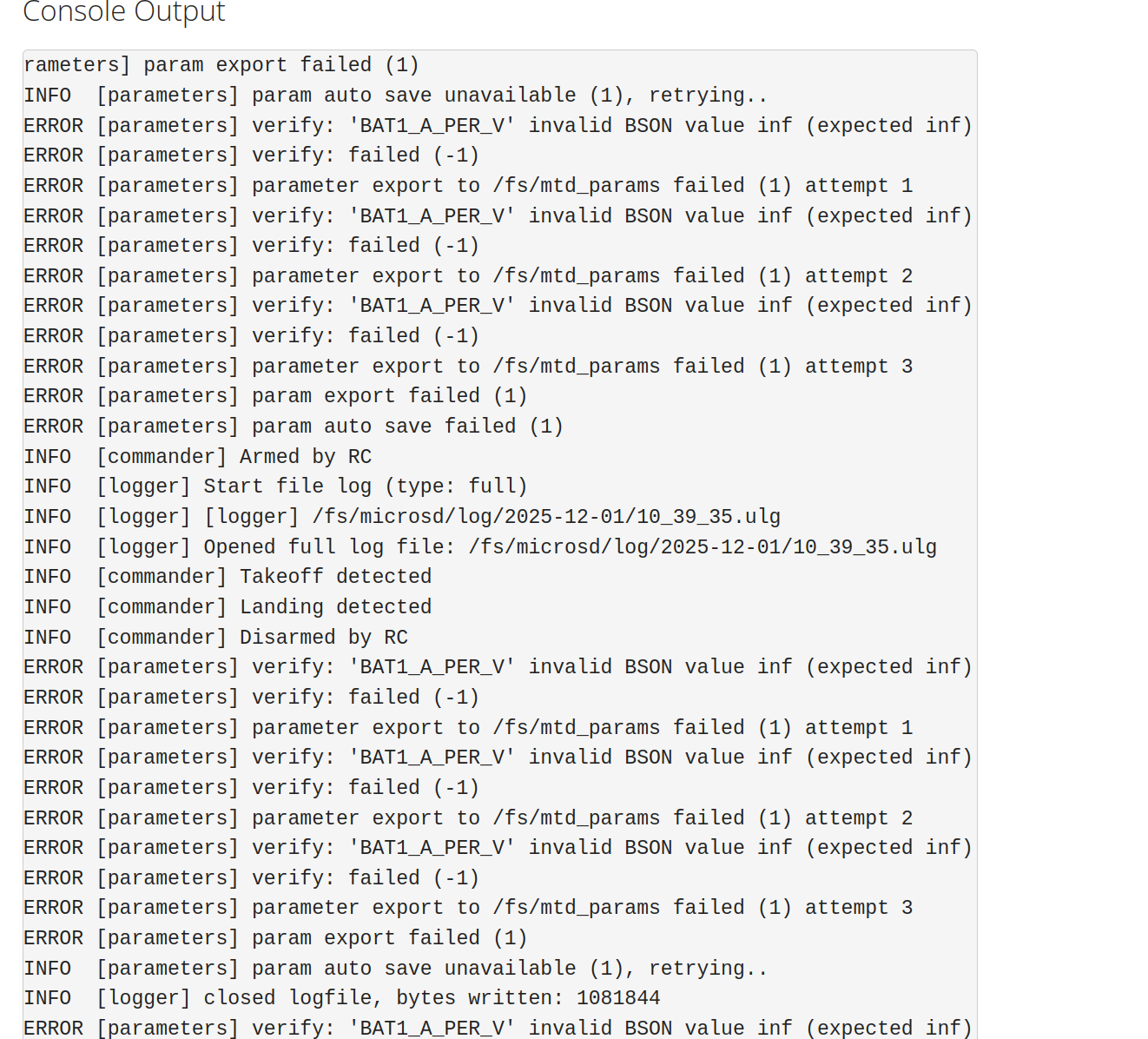

The other thing that I noticed are these warnings regarding param save/export. I’m not sure where these are coming from:
They are usually not there. I would suggest to take a backup of all parameters in QGC, and then reset all params and re-do the configuration and calibration to make sure it is all sane and these errors are gone. Also, make sure the SD card is working correctly.

The param warning are I likely because we didn’t did the battery Amps/Vol calibration. We left the value blank, I think we should have put a dummy value here.
