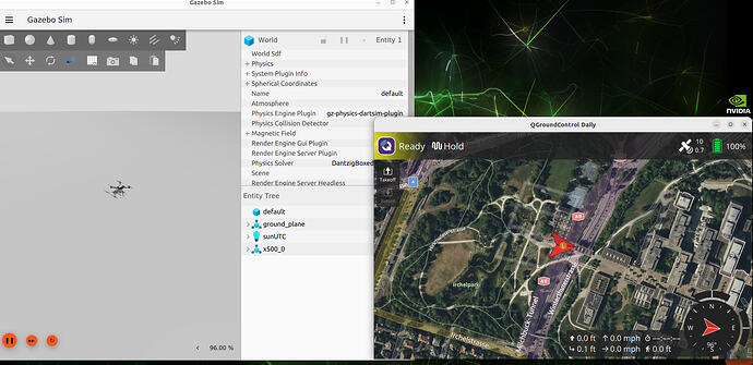

I am trying to install QGroundControl on Jetson Orin Nano. Jetson Orin Nano is on Ubuntu 22.04 with aarch64. I cannot find a stable version of QGroundControl for that Linux architecture. I see one in Daily Build but that version comes with GLIBC_2.38. The GLIBC on Jetson Orin Nano is 2.35. Any help is much appreciated.

Interesting, so it looks like the dependencies to glibc 2.38 might come from Qt6.10.1 then.
The Qt docs confirm this:
The official binaries are built on Ubuntu 24.04 which ships with glibc 2.39, if your glibc is older than what we build with, you need to rebuild from sources.
So, you would have to rebuild Qt from source. What a pain. If it was me, I’d try to get the Jetson to 24.04 first (e.g. see Upgrade Jetson AGX Orin to Ubuntu 24.04 - HackMD).

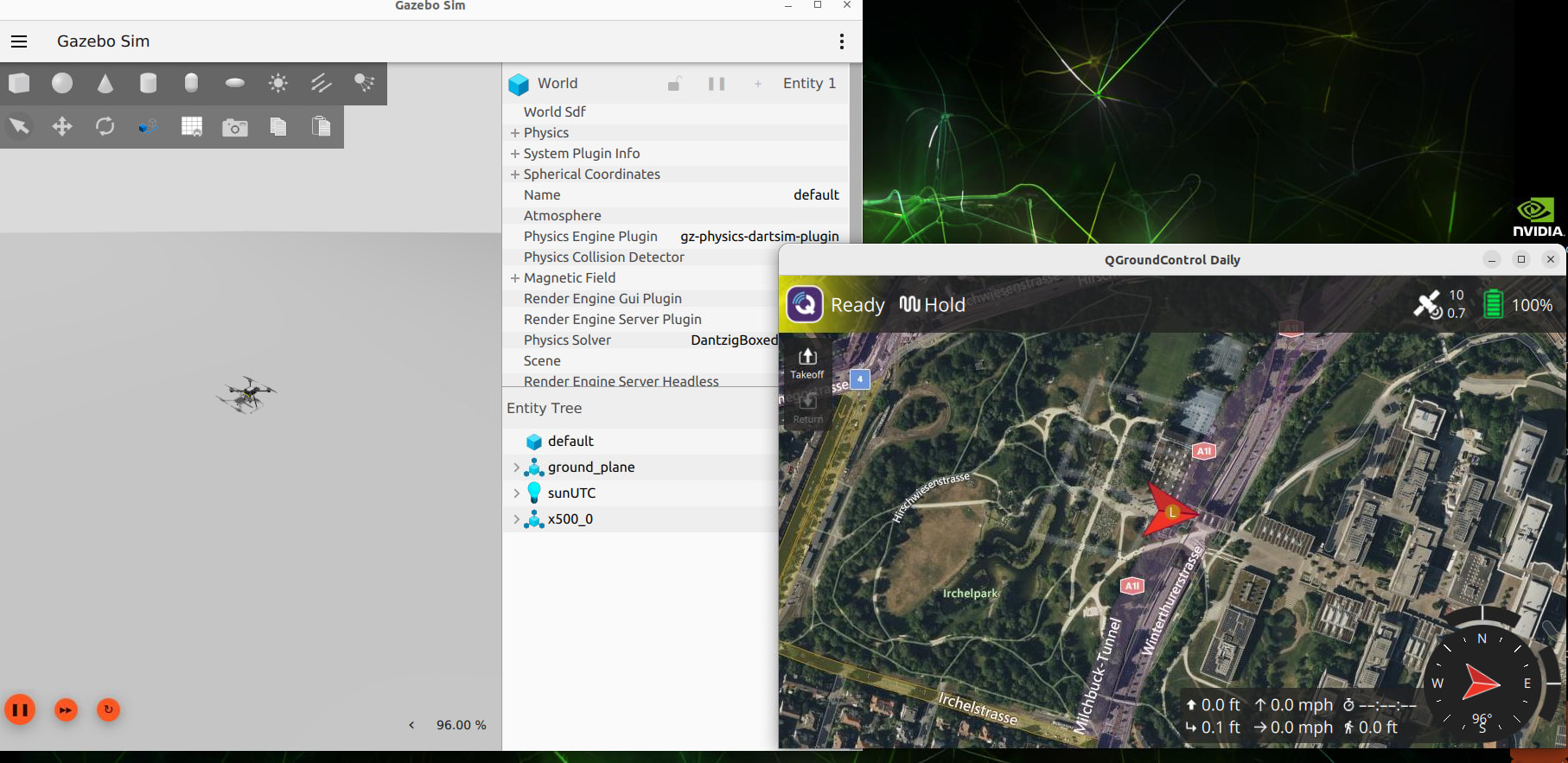

Hi @JulianOes I was able to build and install Qt (6.10.1) as well as linguist-qt6 and finally build and install QGroundControl from source in Jetson Orin Nano.
