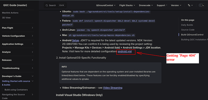

Also not helpful:
The link regarding detailed configuration for Android - in the docs- doesn’t work.
Was wondring myself if I shouldn’t try CI instead, but couldn’t find clear instructions for that.
Thanks for providing yours.
Pull requests to fix the 404 welcome:
