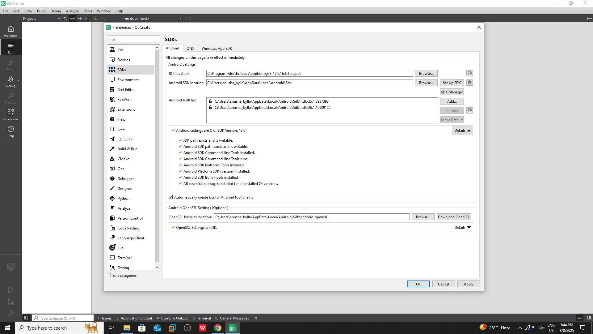

I am currently running QGroundControl v5.0 (stable release) with Qt 6.8.3.
Previously, I followed the official Qt guide for Android to successfully build and install the stable QGC v4.4 version with Qt 5.15.2 for both Android and Windows desktop.

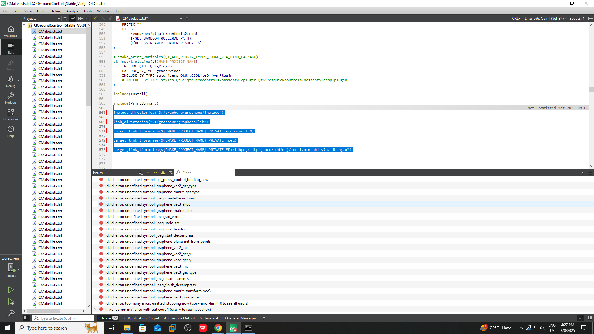

I initially encountered multiple undefined symbol linker errors related to graphene, jpeg, and libpng while building QGroundControl.
To address this, I downloaded the required graphene and libpng libraries as ZIP files, extracted them, and manually added their include and lib directories to the CMakeLists.txt file. I also linked the static libraries (graphene-1.0, jpeg, and libpng.a) using target_link_libraries().
Could you please confirm if these manual changes are the reason I’m now experiencing the current linker errors? I suspect the issue might be related to architecture or compatibility mismatches.

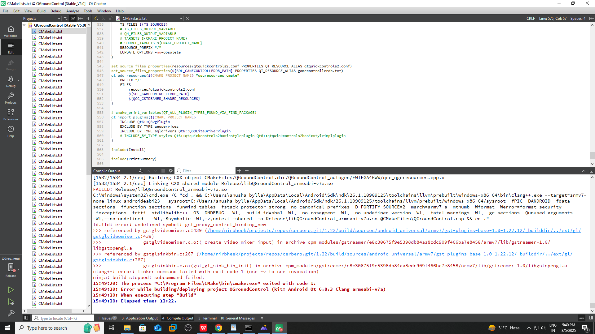

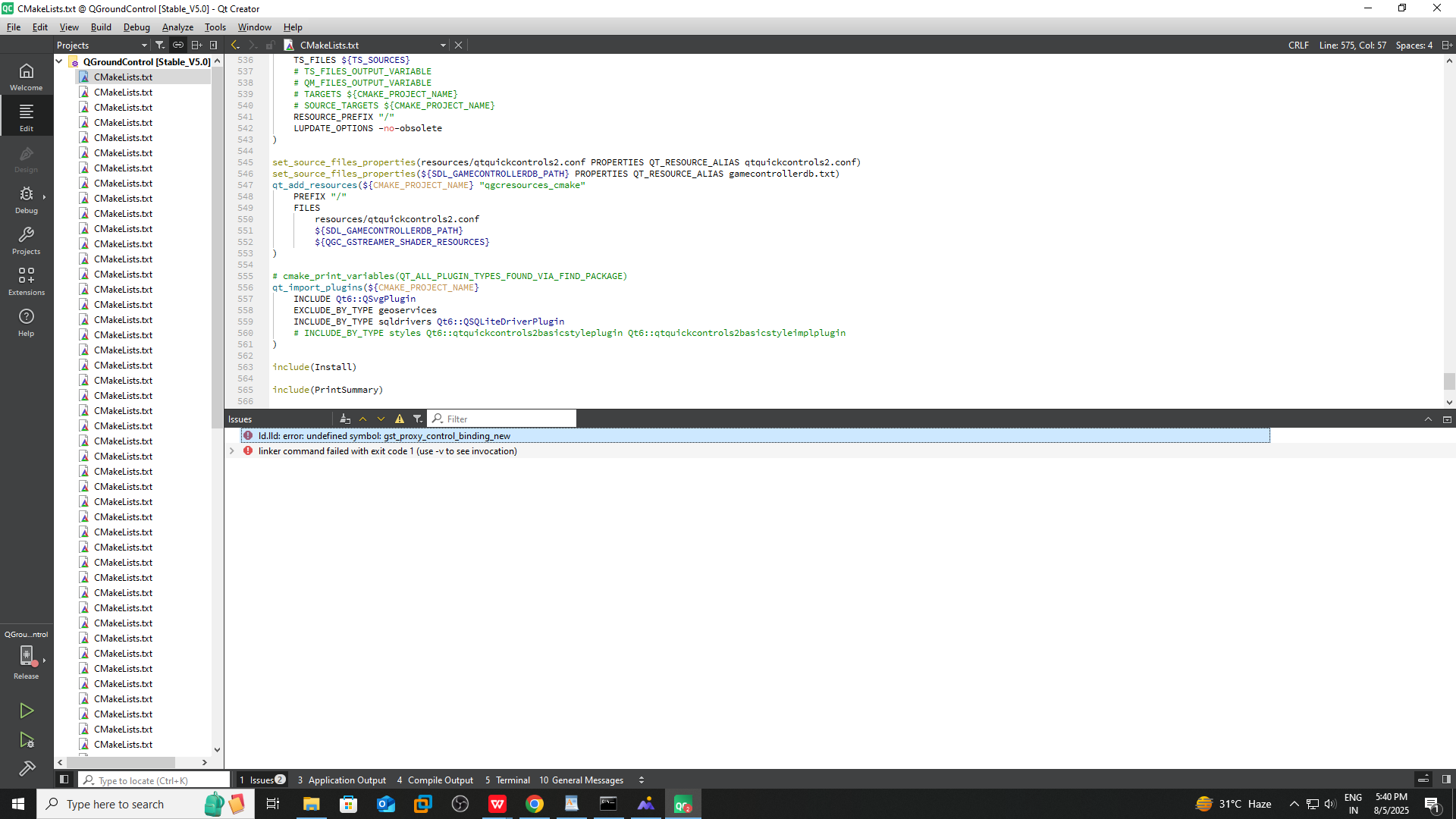

FAILED: Release/libQGroundControl_armeabi-v7a.so
C:\Windows\system32\cmd.exe /C “cd . && C:\Users\anusha_bylla\AppData\Local\Android\Sdk\ndk\26.1.10909125\toolchains\llvm\prebuilt\windows-x86_64\bin\clang++.exe --target=armv7-none-linux-androideabi23 --sysroot=C:/Users/anusha_bylla/AppData/Local/Android/Sdk/ndk/26.1.10909125/toolchains/llvm/prebuilt/windows-x86_64/sysroot -fPIC -DANDROID -fdata-sections -ffunction-sections -funwind-tables -fstack-protector-strong -no-canonical-prefixes -D_FORTIFY_SOURCE=2 -march=armv7-a -mthumb -Wformat -Werror=format-security -fexceptions -frtti -stdlib=libc++ -O3 -DNDEBUG -Wl,–build-id=sha1 -Wl,–no-rosegment -Wl,–no-undefined-version -Wl,–fatal-warnings -Wl,–gc-sections -Qunused-arguments -Wl,–no-undefined -Wl,-Bsymbolic -Wl,-z,notext -shared -o Release\libQGroundControl_armeabi-v7a.so @CMakeFiles\QGroundControl.rsp && cd .”
ld.lld: error: undefined symbol: gst_proxy_control_binding_new
referenced by gstglvideomixer.c:439 (/home/nirbheek/projects/repos/cerbero.git/1.22/build/sources/android_universal/armv7/gst-plugins-base-1.0-1.22.12/_builddir/../ext/gl/gstglvideomixer.c:439)
gstglvideomixer.c.o:(_create_video_mixer_input) in archive cpm_modules/gstreamer/e8c30675f9e5398db84aa8cdc909f466ba7e8458/armv7/lib/gstreamer-1.0/libgstopengl.a
referenced by gstglsinkbin.c:267 (/home/nirbheek/projects/repos/cerbero.git/1.22/build/sources/android_universal/armv7/gst-plugins-base-1.0-1.22.12/_builddir/../ext/gl/gstglsinkbin.c:267)
gstglsinkbin.c.o:(gst_gl_sink_bin_init) in archive cpm_modules/gstreamer/e8c30675f9e5398db84aa8cdc909f466ba7e8458/armv7/lib/gstreamer-1.0/libgstopengl.a
clang++: error: linker command failed with exit code 1 (use -v to see invocation)
ninja: build stopped: subcommand failed.
09:51:14: The process “C:\Program Files\CMake\bin\cmake.exe” exited with code 1.
09:51:14: Error while building/deploying project QGroundControl (kit: Android Qt 6.8.3 Clang armeabi-v7a)
09:51:14: When executing step “Build”
09:51:14: Elapsed time: 00:08.
