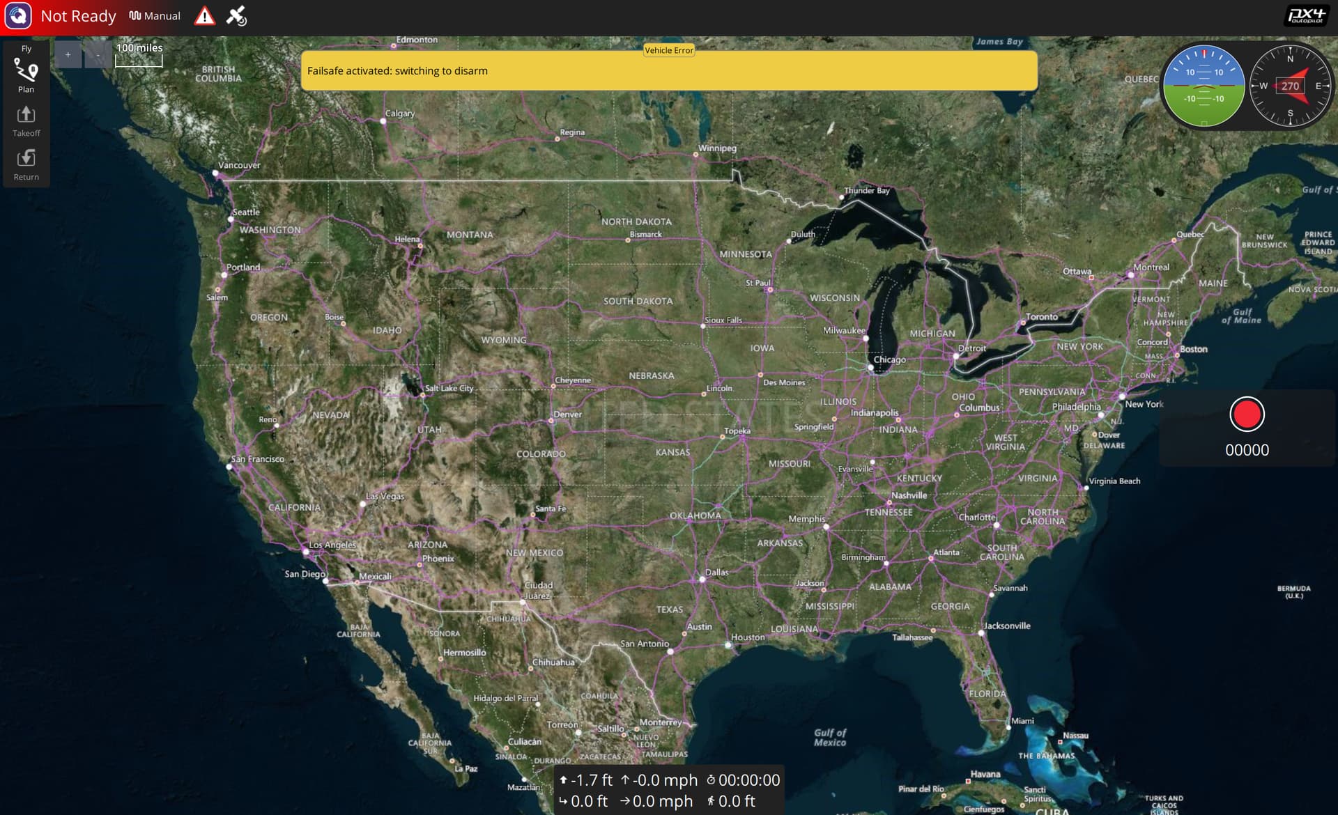

I am using a Pixhawk 6x w/ PX4 in QGroundControl. This is my second time building a drone, this version is basically a copy of my first one.
I am communicating with my FC directly through a USB from my PC. For manual control, I am using a FlySky controller that is plugged into my PC.
I have done all this before, but now I am getting an error (when trying to arm in manual mode) that says:
“Failsafe activated: switching to disarm”
I don’t know what failsafe is activating. Is there a way I can see why a failsafe is activating so that I can work on fixing it? I am not sure where to go from here.
Thanks!
Look at all the warning texts sent by clicking on the exclamation mark in the top bar.
Also click on “Not Ready” and check what it says. And if that doesn’t help, upload a log to logs.px4.io and link it here.
