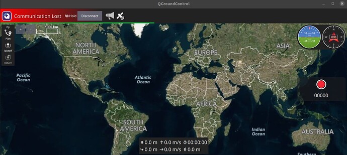

I have Pixhawk 6x pro connected via a Type-C cable showing /dev/ttyACM0. I added in COM-LINK in QGC. QGC is connected for an instance and disconnected again
Following is the output of the terminal

 I checked on another laptop, and it is working fine. I checked the udev rules, and nothing seems wrong. I try reinstalling `QGC` multiple times
QGC version v.4.4.3
OS ubuntu-20.04 LTS

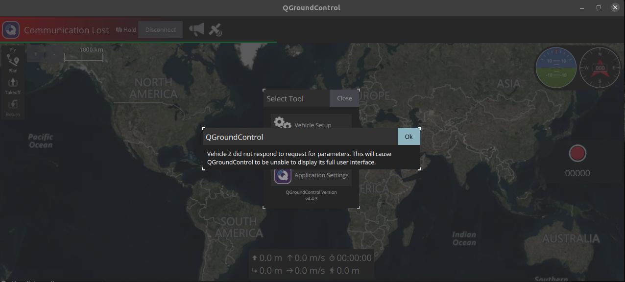

I have a dual boot. I checked the same configuration with Windows, with the latest version of qgc, and it is working fine. I think the problem is on the OS side. but not sure what it is. I ask deep seek and gpt, which all refer to permissions /dev/ttyACM* /dev/ttyUSB* and to cable check
Maybe this interferes with qgc autoconnect? I guess if you specify the comm link manually autoconnect for pixhawk should be disabled? The autoconnect usually works fine for me though, never tried to configure a comm link for USB.
yes it autoconnect. but when not you have to look the serial connection /dev/ttyACM0 or /dev/ttyUSB0 and then add in com-link. /dev/ttyACM* show when you connect flight controller via typec-c cable. if you use FTDI cable you also need to set baudrate when it is not auto connect
