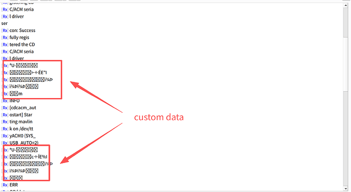

I wrote a custom serial read/write program that binds to a PX4 serial port via parameters (I used Telem3/4).
However, I noticed that no matter which serial port I select to, when I output custom messages, they are always mixed with px4_info/error messages, as shown in the image below.
What could be causing this issue? I am currently testing on version 1.16.0, using the micoair_h743 board. My serial port initialization code is as follows:

My guess is that either the console is enabled on the serial port, or MAVLink.
Check the defconfig file for what UART the console is on, and check the MAVx_ params for the mavlink configuration (or check mavlink status) in the console.
I just checked the deconfig file and found only CONFIG_USART6_SERIAL_CONSOLE set yes, yet I’m not using USART6.
In QGroundControl I also verified the MAVLink parameters: only TELEM1 is used.
Another new finding: when I deployed the same custom module on v1.14.3, this problem did not occur.

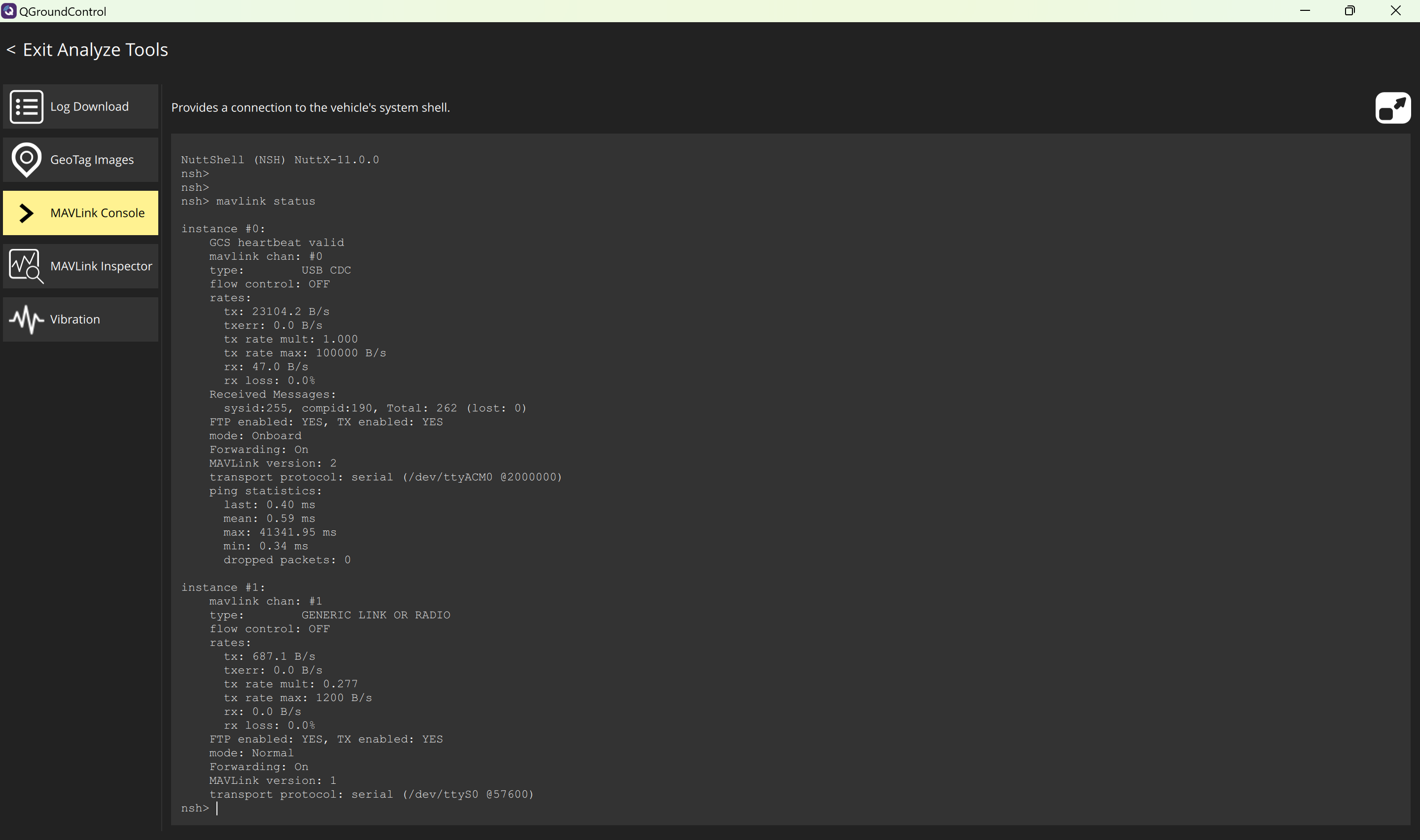

Does that make sense? Can you check mavlink status to see what’s running? Have you configured any OSD on ports?

This is the output of mavlink_status , but I think it’s irrelevant; the information printed on the serial port looks more like system_console messages.
