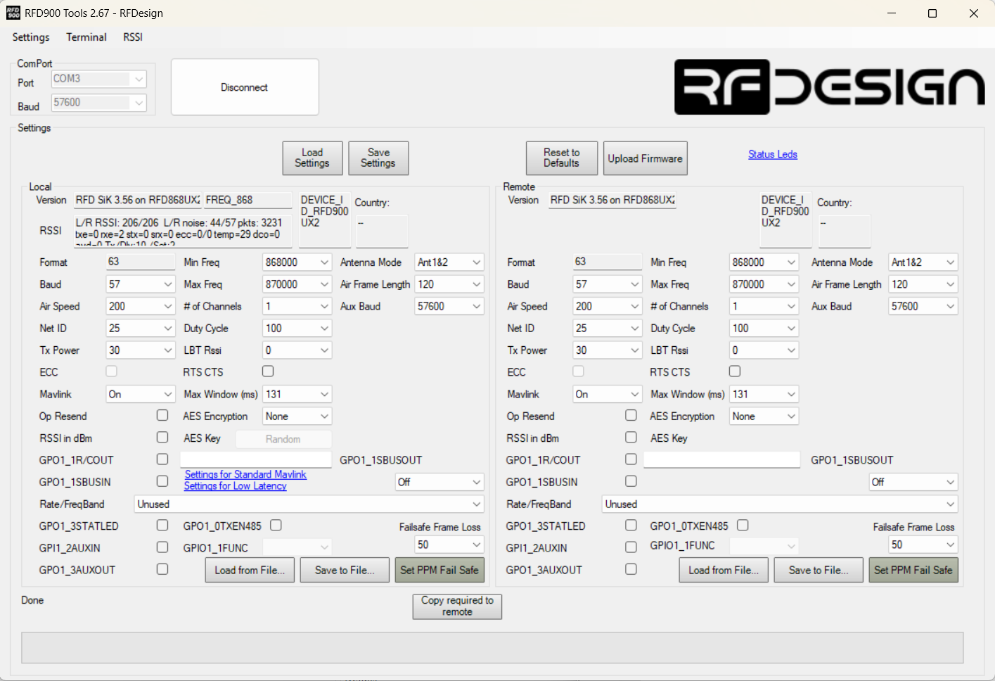

On RFD Tools I have the following default settings to the radios. I am also able to upload and change settings just fine, so it seems the radio link as such is working:

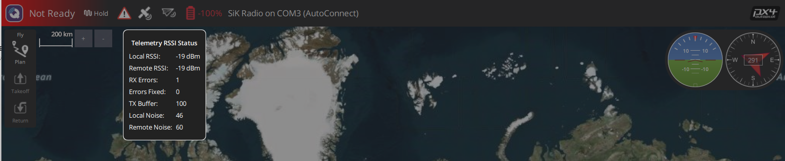

If I have RFD900 Tools connected to COM3 while opening QGroundControl, I get following warning in the Console log:
[D] at C:\a\qgroundcontrol\qgroundcontrol\src\comm\SerialLink.cc:209 - “open failed “Access is denied.” QSerialPort::PermissionError “SiK Radio on COM3 (AutoConnect)” autconnect: true”
To me this seems like QGroundControl has detected that there is a SiK Radio on COM3. When I start QGroundControl without the RFD900 Tools blocking the port I dont get that error.

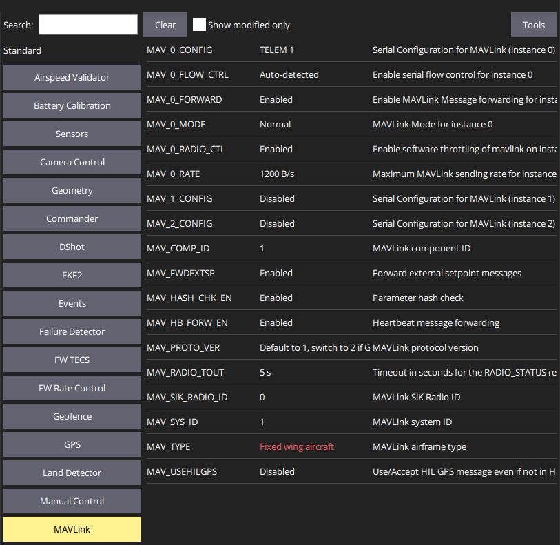

I have the following setting in MAVLink for the vehicle:

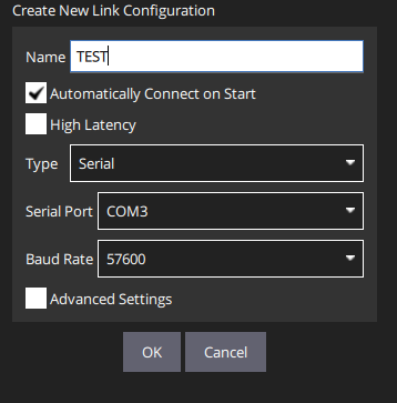

When attempting to just get a communication with the RFD868, the system simply remain in “disconnected” state. When I set manually the COM3 as Serial communication link:
and try to connect via the button I see in the QGroundControl Console some errors referring to MAVLink:

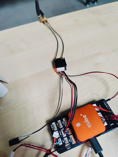

I am not sure if these link to the above issues. I have the RFD868 wired directly to the TELEM1 output of the board, there is currently no external power.

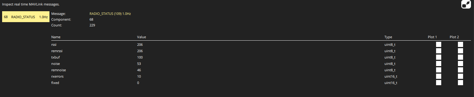

However, when using PX4 v1.14.3 (compiled through MATLAB/Simulink for our flight control algorithms), I now see that there is some sort of a link but no other telemetry data streams are sent:
With 1.14.3 the only sign of life is:
With 1.16 (all working):
The question is now that what has changed from 1.14.3 to 1.16 to make the RFD868ux radio work…
