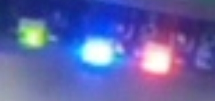

Hello, I am trying to get a PWM output from the PX4 IO module, but I am not receiving any output.
System Features:
  • Holybro Pixhawk 6X
  • PX4 Autopilot (1.15.4 version)
  • Holybro M8N GPS
I have built my own board for PX4 6X. I checked the outputs, and ports like I2C, Telem, and GPS (partially working) are functioning, but the IO port is not working. So, I downloaded and built the PX4-Bootloader GitHub repository and flashed the board through the IO debug section (px4io_bl and px4iov3_bl). The LEDs started to light up, but I still cannot get a PWM output from the IO port. The IO LEDs are blinking as shown in the video below, and as far as I understand, there is an issue. In older versions, there was a parameter called ‘SYS_USE_IO’ that needed to be enabled. Right now, I cannot figure out what is wrong with the system. Thanks for your help.
Did I make a mistake while flashing the IO bootloader for PX4 6X? Is there a page that explains this process in detail? I followed the Bootloader Update page, but it is written for FMU.
Note: I am receiving GPS data, but the LED on the GPS module is not working
