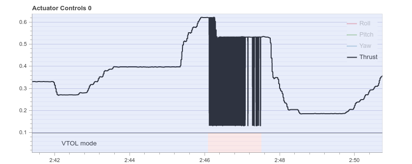

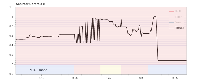

Bug report for tailsitters: Thrust setpoint incorrect during transition. Reportedly reproducable in SITL.
We need to either fix and support tailsitter or make it clear that we can’t currently support it since no maintainer actively flies tailsitter at the moment. We’ll ask @RicardoM17 for help on that topic. We should also reenable tailsitter tests once this is fixed.
opened 08:29AM - 27 Oct 20 UTC
closed 08:46PM - 18 Jan 21 UTC
**Describe the bug**
When we are performing a VTOL transition with a tailsitter… type drone We are getting very weird thrust fluctuations. It seems that it's taking two references basically at the same time, I would assume from the MC and FW controllers.
Also in simulation we don't get this issue.
More over @xdwgood also reported this issue on PX4 slack, thus proving that this issue is on upstream PX4 and not custom software.
**To Reproduce**
Use a VTOL Tailsitter type drone and perform a transition.
**Expected behavior**
The thrust reference should be smooth during transition.
**Log Files and Screenshots**
https://logs.px4.io/plot_app?log=1e0b41e7-79d0-4d75-be15-27168f4274cc
https://review.px4.io/plot_app?log=6ce3fbeb-33d0-44db-8232-f3f9dd0f87b2
**Additional context**
@xdwgood reported that setting MPC_USE_HTE to 0, i.e. disabling the hover throttle estimator, seems to solve the issue. It's still to be confirmed but I'm still creating this issue to keep track of the problem as it should be fixed entirely.
@sfuhrer @RomanBapst FYI
