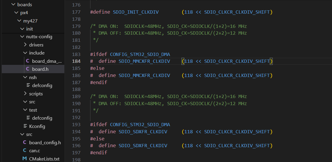

I’m working on a custom PX4 flight controller based on STM32F427 (FMUv4-style design), and I’m currently facing an issue with SD card parameter storage.

  • SD card: Kingston 2GB (formatted as FAT32)
  • SDIO interface (4-bit mode, external module via wires ~20 cm)

  • Reducing SDIO clock divider (even to very low speed) does not fix the issue
  • Using external SD module connected via wires (not on PCB)

The most useful thing you can do is submit a draft PR with your custom board config against PX4-Autopilot (even WIP is fine) and upload a full boot console log or .ulg to logs.px4.io. Seeing your defconfig, board.h, init.c, and pin definitions will let us spot the problem directly. Without that we’re guessing.
Things to check against the fmu-v3/fmu-v4 reference boards (both STM32F427, same as yours):
  1. Make sure you changed the right clock dividers. There are three in board.h. Mount and mkdir use the init clock (400 KHz), but param save does bulk writes at the data transfer clock. If you only lowered SDIO_INIT_CLKDIV, that won’t help:
// Init clock (400 KHz) -- NOT the one that matters for writes
#define SDIO_INIT_CLKDIV    (118 << SDIO_CLKCR_CLKDIV_SHIFT)
// Data transfer clocks -- THESE control param save speed:
#define SDIO_MMCXFR_CLKDIV  (1 << SDIO_CLKCR_CLKDIV_SHIFT)   // 16 MHz
#define SDIO_SDXFR_CLKDIV   (1 << SDIO_CLKCR_CLKDIV_SHIFT)   // 16 MHz
Try a much higher divider for the transfer clocks, like 23 (~2 MHz) or 47 (~1 MHz).
  1. Check for CONFIG_MMCSD_SDIOWAIT_WRCOMPLETE=y in your defconfig. Without it, NuttX doesn’t wait for the card’s write-complete signal before sending the next command. Small metadata ops (mkdir) can get away without it, bulk writes can’t.
  2. Check for DMA stream conflicts. SDIO uses DMA2 Stream 3 or Stream 6, Channel 4. If another peripheral in your config claims the same stream, writes will fail silently. Compare your DMA mappings against boards/px4/fmu-v3/nuttx-config/include/board_dma_map.h.

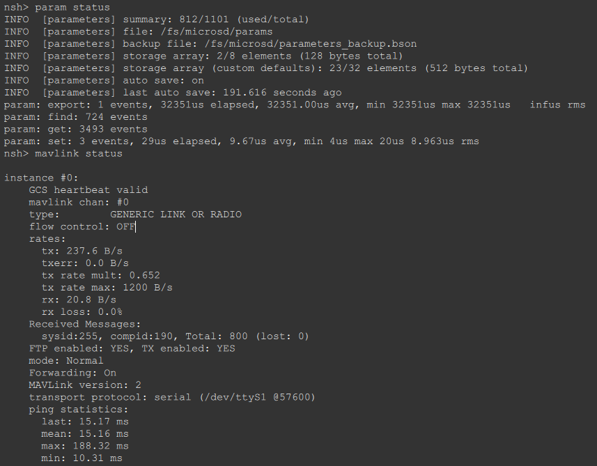

I would like to share the final result after testing, in case it helps others with a similar problem.
At first, I thought the SD card was the cause, because whenever I inserted the SD card, QGroundControl could not fully load the parameters and I could not enter the Setup page. However, after testing through NSH, I confirmed that the SD card itself was working properly. The board could mount the SD card, save parameters to /fs/microsd/params, and create log files normally.
After following the advice here, I checked the telemetry and MAVLink configuration more carefully. I found that the main issue was related to the telemetry link when QGroundControl was downloading parameters. TELEM1 was configured as the GCS port, but the parameter transfer was not stable enough, which caused QGC to get stuck while loading parameters.
After reducing the clock transmission frequency, the QGroundControl still failed to load the parameter. Then I came up with a solution: increasing the parameter loading capability via TELEM1.
Your TELEM1 is already on the default GCS port, but the default PX4 has MAV_0_RATE=1200 B/s on TELEM1. Try this:
param set MAV_0_RATE 0
reboot
TELEM1 is the default GCS MAVLink port with MAV_0_CONFIG=TELEM1, MAV_0_MODE=Normal, SER_TEL1_BAUD=57600, MAV_0_RATE=1200. Parameter loading errors in QGC are usually due to noisy or high-loss communication links, so this step is to eliminate link errors first.
I then reduced the MAVLink transmission rate by changing the corresponding parameter, and after that the situation improved significantly. QGroundControl was finally able to download parameters correctly and I could enter the Setup page without the previous error.
At the moment:
  • parameters are saved correctly
  • /fs/microsd/params is working
  • telemetry communication is stable
  • mavlink status shows a valid GCS heartbeat and no packet loss
  • QGC can now enter Setup normally
So the root cause was not the SD card itself, but the telemetry communication during parameter download.
I also attached screenshots and test outputs above to show the results more clearly.
