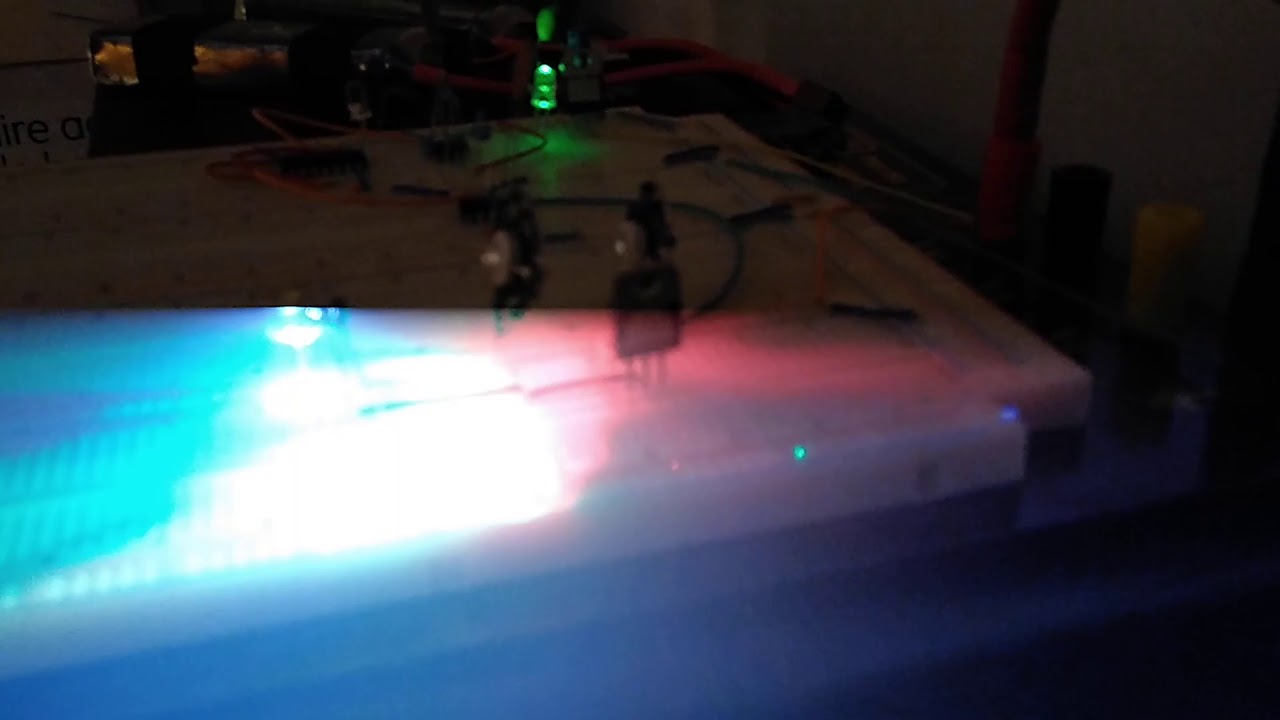

What I am currently working on is a very simple self contained controller built out of a few ICs and a N channel MOSFET - no software. It pulses LEDs twice every second - blink blink pause, blink blink pause.
I haven’t yet fully explored alternatives such as a small microcontroller such as an 8-pin PIC, which while providing additional capability will likely consume more current.
I have tested the circuit with small LEDs and await the arrival of one watt LEDs in red, green, and white. The MOSFET output stage has roughly 60 amp drive capacity, allowing for quite a few LEDs to be driven in parallel, each with their own current limiting.

I am designing a system to drive LEDs in parallel, each with it’s own current limiting resistor in series.
This way, the user can add LEDs as desired, as long as they have the appropriate series resistor for the LED and the supply voltage. Also as long as the load of all the LEDs doesn’t exceed the 60 amp capacity of the MOSFET output stage. Nothing about the design of this circuit prevents the use of LEDs in series. It is up to the user to ensure that the 60 amp drive capability of the circuit and the current limit of the LEDs are not exceeded.
I am quite familiar with the details of properly driving LEDs. For a low duty cycle “strobe” sort of operation, series resistors for current limiting work just fine, as long as the resistor is chosen properly for the supply voltage and the LED in use. The only downside of such a simple driving circuit is a (yet to be determined and likely minor) decrease in brightness as the supply voltage decreases.
Currently testing with 1 watt LEDs. A 33 ohm series resistor apparently works fine. The current duty cycle of 10-20% (blink blink pause) ensures that 1/4 watt series resistors don’t thermally self destruct.
The current test setup is so bright as to be painful to look at and difficult to share via video.
We have it covered with a coffee mug most of the time to avoid damage to our retinas. This has exposed a likely enhancement - a “night mode” (easily implemented with a switchable series resistor). Trying to upload video of the test setup.
